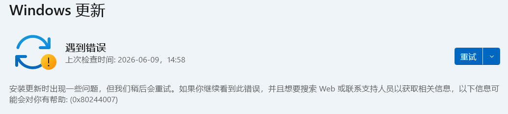

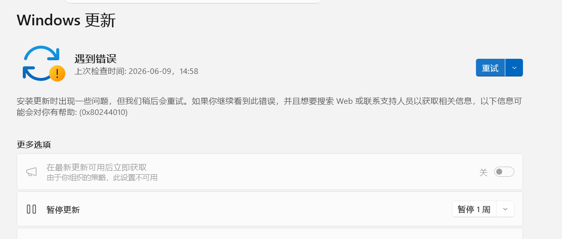

Windows 11 25H2 Pro的电脑,不能通过WSUS更新,但是通过Internet可以。
彭思源 80 信誉分
2026-06-11T05:58:58.3533333+00:00
如图所示:
e575efffc2b5bec74fdc4aa580be6e48
已试过清除C:\Windows\SoftwareDistribution文件夹,重启wuauserv服务等,都无效。
此电脑可以正常访问网络资源,和WSUS服务器通讯也是正常的。

    Please try clicking the Retry button on the Windows Update screen a few times. Each time you retry, the download does not start over, it resumes exactly where it left off. After a few manual attempts, the catalog will finish synchronizing, the error will clear, and the client will successfully report its status. To prevent this heavy catalog burden from happening to other machines you reset, you should run the WSUS Server Cleanup Wizard on your server to decline superseded updates, which will significantly shrink the size of the overall catalog being sent over the network.
    Regarding your second screenshot where the client appears as Windows 10 Pro despite being a Windows 11 machine, do not be alarmed. This is a well-known cosmetic quirk within the WSUS console. Because Windows 11 shares the exact same core 10.0 kernel version architecture as Windows 10, the server natively displays it under the older name. This visual mislabeling has absolutely no impact on functionality, and your machine will still request and receive the correct Windows 11 update payloads once the manual retries allow the synchronization to finish.

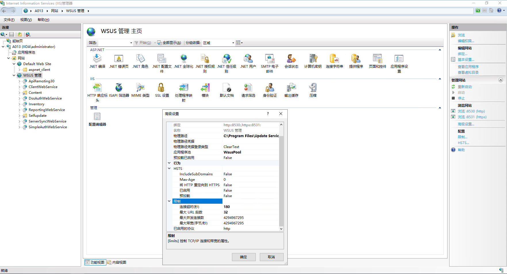

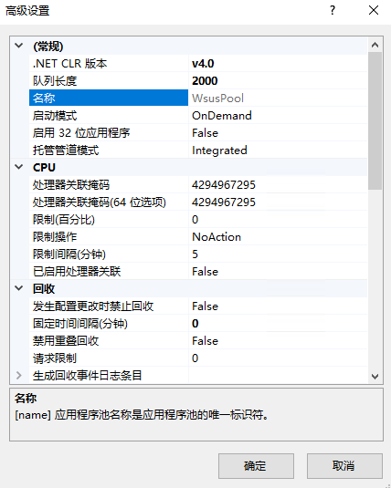

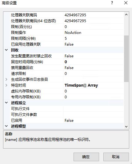

    彭思源 缺失选项不仅仅是翻译差异,而是因为你当前查看的配置是错误的组件。你已经打开了WSUS网站本身的高级设置,该设置管理网页绑定和网站行为。我们需要修改的内存限制和队列限制与工作进程相关,这意味着我们必须调整应用池的设置。
    要找到正确的配置区域,请查看屏幕最左侧的连接面板,点击“应用程序池”,它正好位于你当前展开的“网站”文件夹上方。选择这个后,窗口中间部分会显示一个活跃池的列表。从列表中找到并选择“WsusPool”条目,然后点击“高级设置...”在屏幕最右侧的动作菜单里。
    一旦打开正确的应用池高级设置窗口,你就能找到所需的参数。在“常规”类别的顶部附近找到“队列长度”设置,并将其数值提高到2000。接下来,向下滚动到“回收”类别,你会清楚地看到“专用内存限制(KB)”参数。将该值改为0即可完全消除内存限制。点击确定保存配置,然后用右侧菜单重启应用池,这样服务器就能开始处理更新负载而不会崩溃。

    0x80244007错误代码是SOAP客户端同步失败,表示客户端与服务器之间的通信桥突然中断。根本原因很可能是你的服务器资源耗尽,原因是统一更新平台导致的。这种现代更新架构以一种需要大量内存的方式打包更新,导致托管更新环境的互联网信息服务(ITS)网络服务器过载。当 Windows 11 客户端请求这些大型更新目录时,专用的 WsusPool 应用池会迅速达到其默认的内存上限约 1.8 GB,导致崩溃,导致连接中断。
    要解决这个问题,你必须授权更新服务对更多服务器资源的访问权限。访问您的服务器,打开互联网信息服务管理器,然后进入应用池目录,找到 WsusPool 条目。打开该存储池的高级设置,在回收类别中查找私有内存限制参数。将该值改为零可以消除默认限制,允许服务在高更新周期内消耗所需内存而不崩溃。此外,请在同一菜单的通用类别中查找“队列长度”设置,将默认的1000增加到2000,以更好地应对较高的流量。保存这些更改后,重启 WsusPool 以应用新配置,并允许客户端成功同步。
