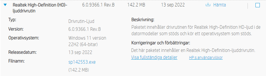

    I did one more check regarding the drivers.
    This is details about the one I downloaded.

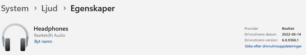

    But still it says June 14 here
    Why is it like that? Didn't the installation work? Did I only get the new Omen Audio Control?
    I'll try again during the weekend and let you know if something changes.

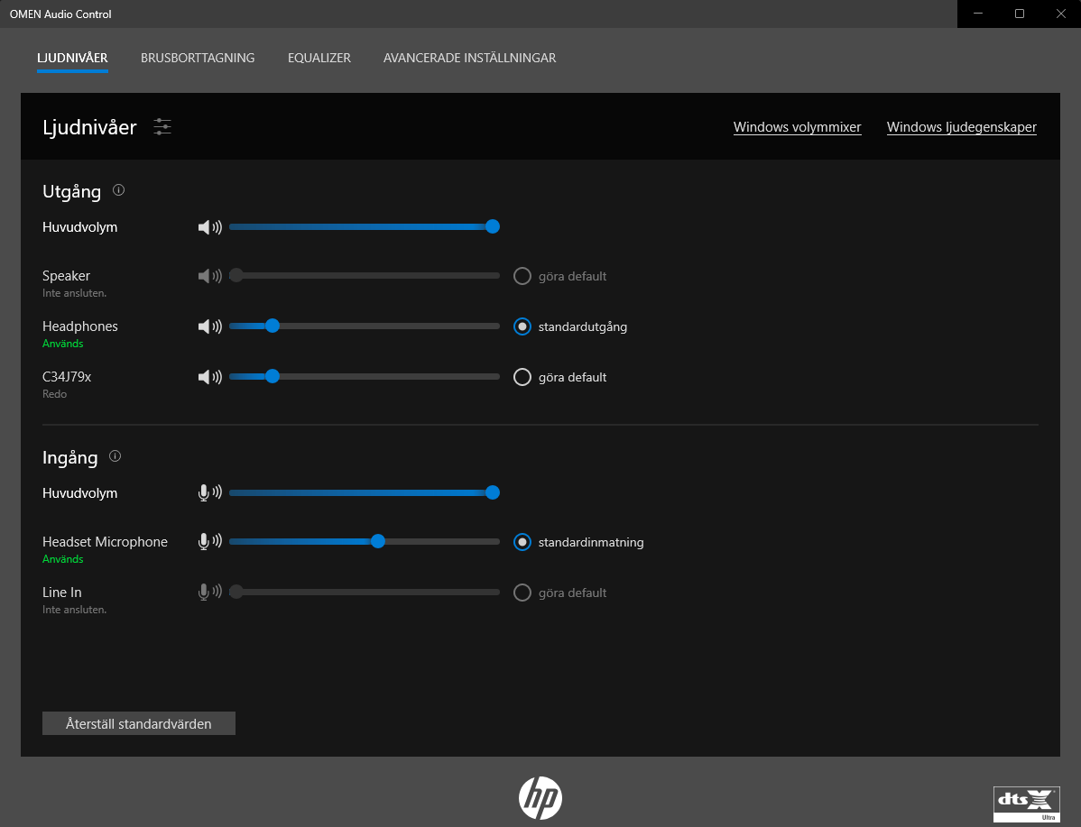

    Hello again Jason!
    With the new driver I got a new Omen Audio Control that I didn't have before. I tried all settings but nothing changes the problem with a 2 second delay unitil selected volume is reached.
