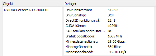

    Method C Driver. According to Windows I have the latest Driver but checking the Nvidia homepage there is a new one available.
    I have version 512.95 factory installed.

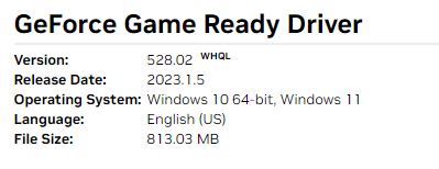

    Available at Nvidia is version 528.02 which I have downloaded but not yet updated.
