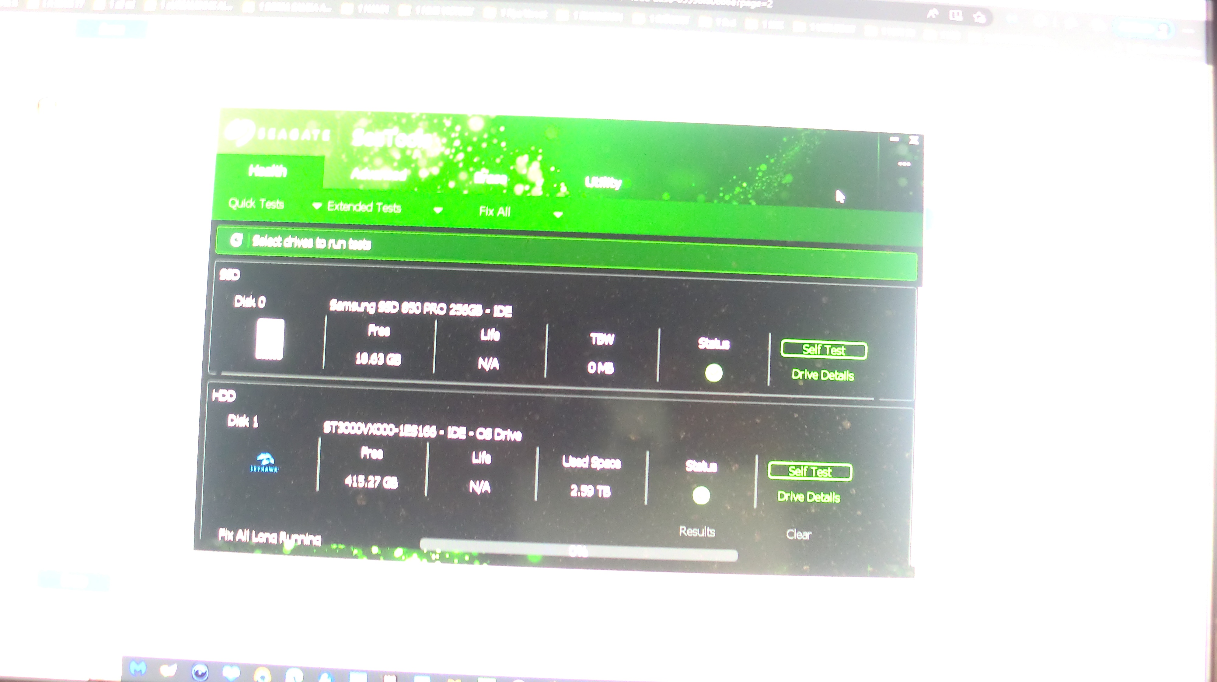

    Seagate long run test check The entire disk. I ve 2 part C;Windows and o; data. I stopped The program when I saw this. At about 26%.

    Im running Seatools program now: FIX ALL LONG RUNNING. Is that what you ment: Your info is translated to swedish and the program is in english and its impossible to knew what is what. Could you please uncheck the translation to swedish :-)
