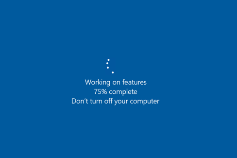

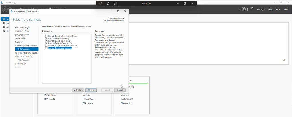

Hello,
I am having an issue with the Remote Desktop Services role installation on Windows Server 2022 V2 that only happens on Azure virtual machines with D4as v6 size, the Add Roles and Features wizard reboots the VM to finish the installation but it get's stuck on 75% at the blue screen and after some minutes it fails and rollback the role installation and the VM reboots to Windows with the roles not installed.Imagem do usuário
Imagem do usuário
I have tested with 3 different subscriptions in different tenants and the same issue occurs consistently. The VMs where created from scratch using the marketplace Windows Server default image, when using the D4as v5 size the issue doesn't occurs.
I believe this is a bug on Azure, just wanted to report it to Microsoft because other users can have the same issue. I have spent 8 hours trying to troubleshoot what I was doing wrong but at the end it was only the D4as v6 size.
