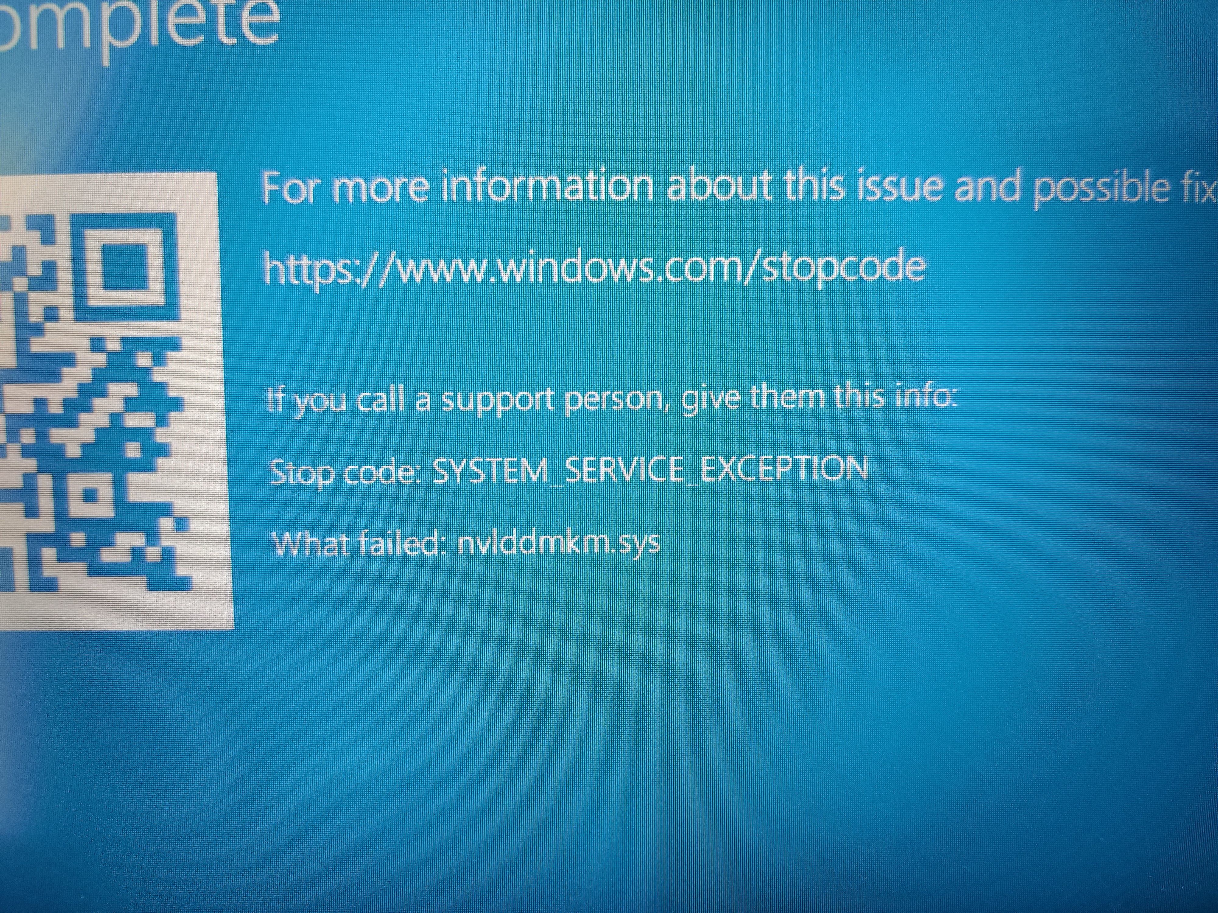

Hello,
I've been trying to get my PC to work on my TV for a while now, even bought a new HDMI cable that can handle 4k at 120hz. 4k at 60hz works just fine but when I try to enable 120hz/HDR on my PC to the TV it keeps crashing, blue screen. The TV does support 4k 120hz HDR.
I've tried updating drivers, going into windows and Nvidia control panel to try and put it in through there but nothing seems to work.
I have an 3060 with a i7-11th gen, 16gb ram. From what I know this should be able to run both 120hz and HDR but it keeps crashing with stop code "SYSTEM_SERVICE_EXCEPTION" and what failed "nvlddmkm.sys".
I hope I can get some help here cause I'm getting desperate. Thanks in advance.

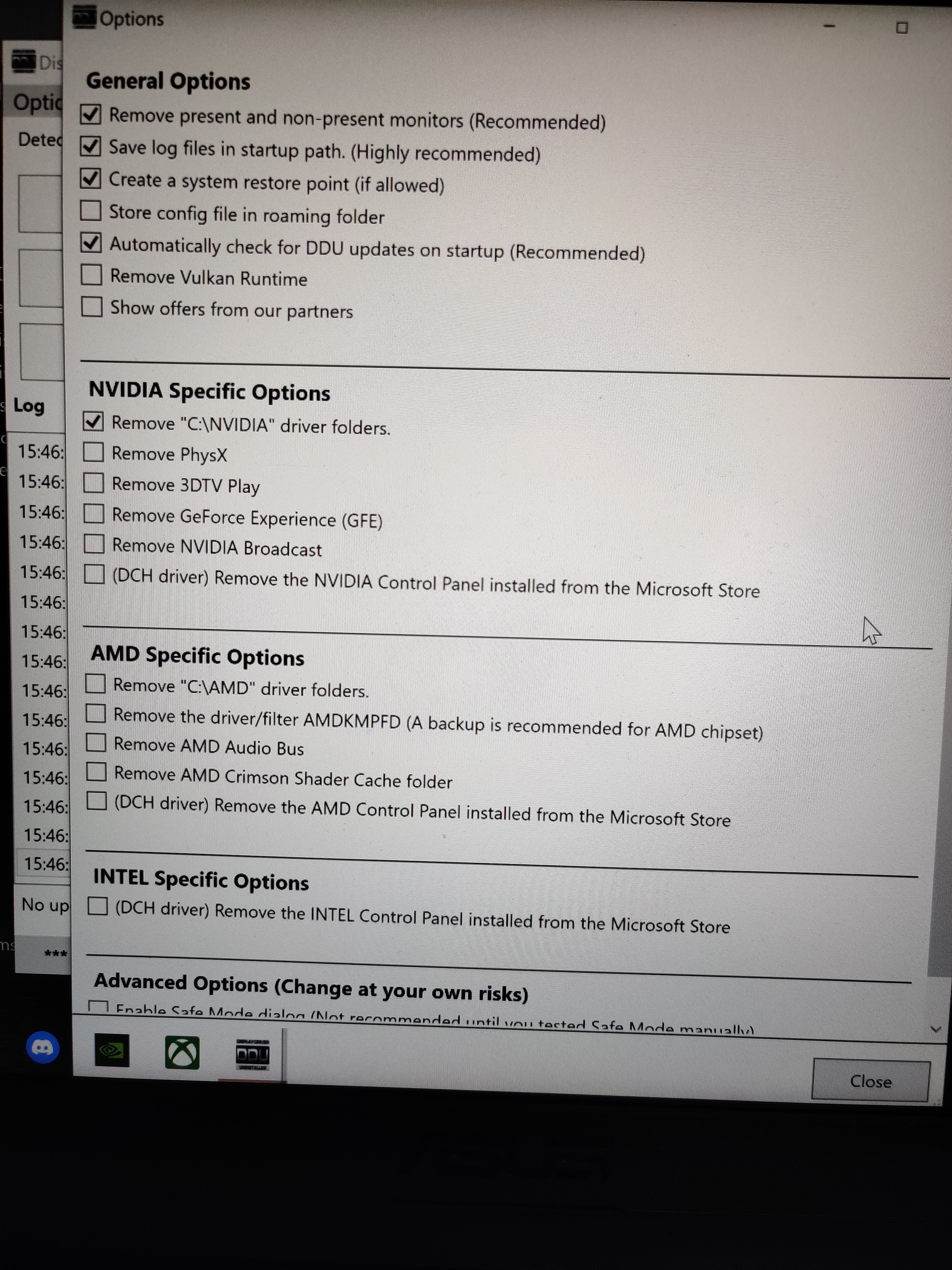

    I did everything you said yet it still keeps crashing with the same code. I downloaded the slightly earlier version of the driver and selected this through the DDU before installing the new driver:

  5. DaveM121 952.8K Reputatiepunten Onafhankelijke adviseur
    2023-01-07T14:01:54+00:00
    Hi Ajkur,
    I am Dave, I will help you with this.
    Completely remove the current Nvidia device driver using the widely available free DDU utility, then restart your PC and go to the support page for your PC on the manufacturer's website to download and install their recommended version of the Nvidia device driver.
    A slightly older version of that driver is more stable than the latest version.
