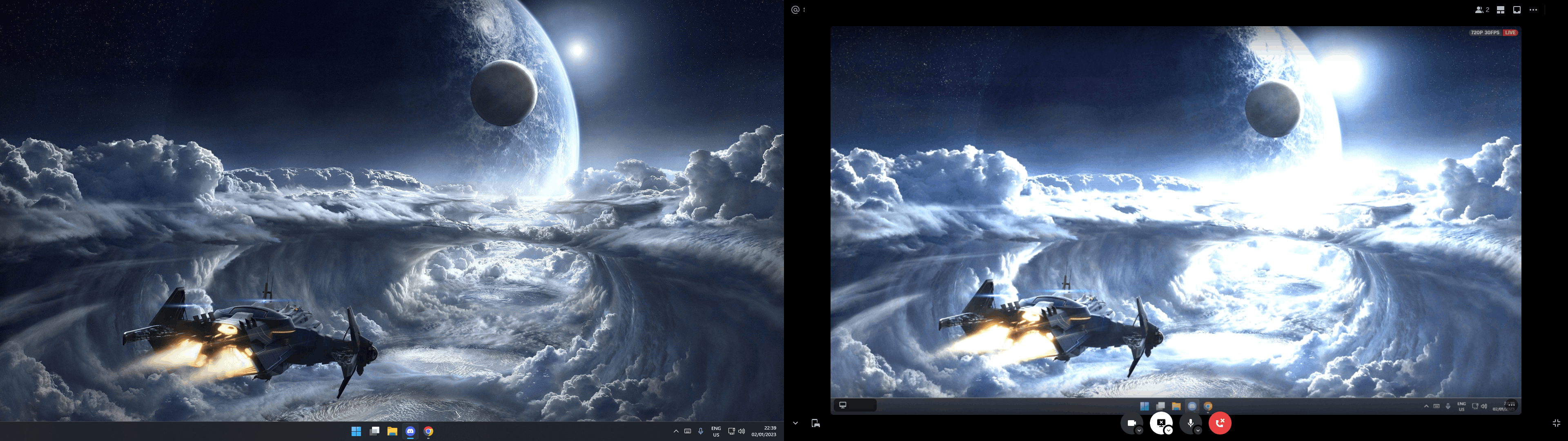

Me and some friends have all noticed that whenever we have HDR enabled on our display, and we are using different applications such as: Microsoft Teams, Discord, Zoom etc to share our screen that has HDR enabled, that the brightness of the screen becomes way to high for the person viewing the stream.
This happens on the latest version of windows 11 on multiple different computers with the exact same settings. So the issue is reproducible.
Below you will see a screenshot of someone viewing the screen that they are sharing on the right, and the screen that they themselves are viewing on the left (screenshot).
This issue does not happen when using recording software such as OBS or graphics drivers to record the screen. Nor does it happen when taking screenshots. The only moment this is an issue is when different applications are sharing their screen with other users. So there is probably some sort of underlying SDK that has issues with HDR.
Does anyone know if this is a known problem at microsoft and whether there is a workaround for the problem, or whether there is anyone looking into this? Can we expect a windows update to solve this problem?

    I've read the microsoft answer you've linked but don't see a resemblance between the two topics. In my specific use case this is about windows 11 on pc only, and I've tested this with 3 different screens on 3 different computers all exhibiting the exact same symptoms I've described.
    these are the steps to reproduce my issue:
    • have windows 11 correctly setup with all of your drivers including graphics (doesn't matter whether on amd or nvidia)
    • connect a hdr display and turn on hdr under display settings in the settings app
    • start a call with someone in your favourite conferencing software such as microsoft teams, discord, zoom
    • start sharing your hdr enabled screen to the other party you are conferencing with.
    • the other party now sees a high brightness compared to what you see on your screen, making things hard to see on the screen share.
    You can try this with the latest version on windows 11 with any hdr capable monitor and any graphics card.
    Hopefully this explains my situation more thoroughly.
