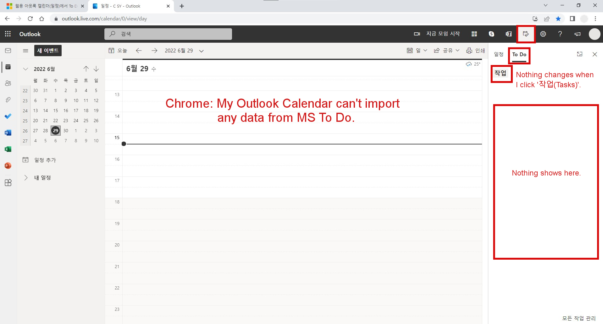

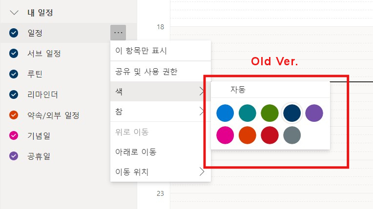

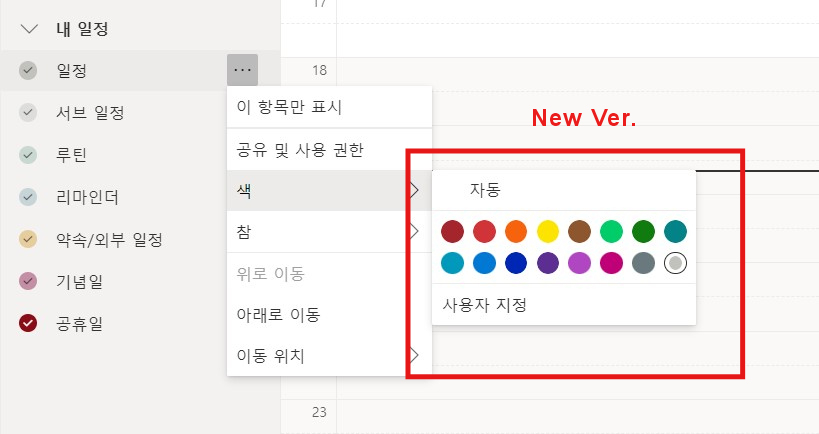

    Do you remember I said the Calendar imports data from To Do only in Internet Explorer and MS Edge(after using IE), not in other browsers including Chrome?
    The problem might have to do with the recent update MS realeased, not different browsers.
    The reason why IE worked properly was that IE opened the older version of the Calendar even though I used the same address for all browsers.
    It seems like when IE was automatically linked to Edge, IE sent the link of the older version to Edge.
    That's why Edge didn't worked before, then suddenly started to work properly opening the old version.
    The most noticeable feature of the update was a wider range of colors for "My Calendars" menu.
    I notice that the setting of the Calendar in IE and MS Edge(after being linked from IE) belongs to the older version. (Pleased find the attached pic.)

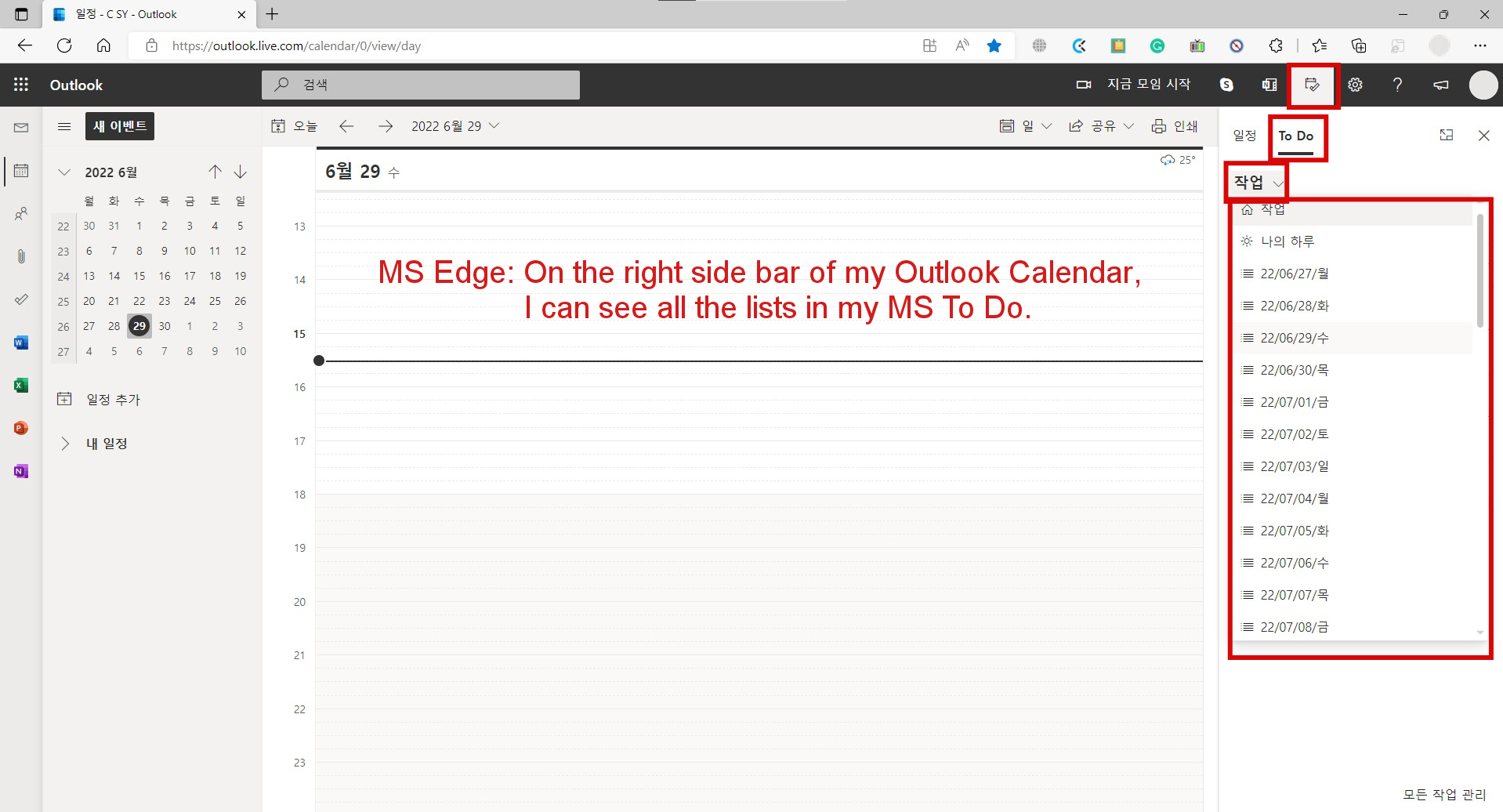

    IE and MS Edge(linked from IE): The old ver of Calendar imports data from To Do
    이미지
    Other browsers: The new ver of Calendar CANNOT import data from To Do
    이미지

    MS Edge and Firefox didn't work (They are the same as Chrome. The Calendar works fine but can't import data from To Do),
    but Internet Explorer worked properly!
    When I closed the IE browser and tried it again to make sure it works, the message saying I should be using MS Edge popped up and
    I was moved to MS Edge automatically.
    I was sure Ms Edge wouldn't work because it didn't work just 15 minutes ago, but it suddenly started working after I was automatically moved from IE Explorer. It doesn't make any sense to me, but now I can see all the lists in To Do on the side bar of the Calendar.
    Chrome and Firefox still don't work.
