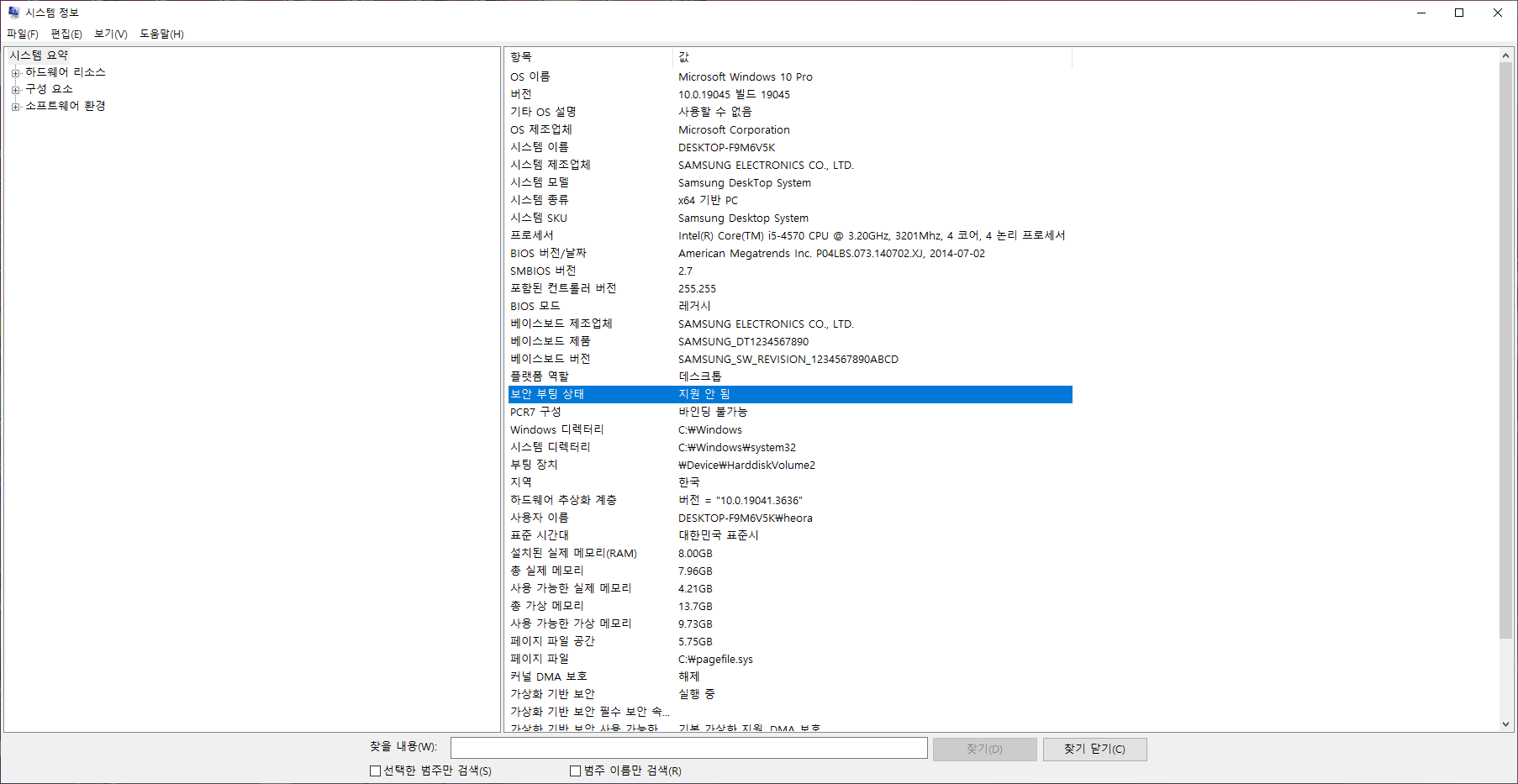

  3. DaveM121 938.6K 평판 포인트 독립 자문가
    2024-06-19T10:47:28+00:00
    If you have replaced that battery, is the time on your PC now correct after you set it?
    With regards to the BIOS version, the only way to update that is to check the support page for your PC on the Samsung website to check if there are any BIOS updates available.

  4. 익명
    2024-06-19T10:43:32+00:00
    This is the system information that appeared after I replaced the battery. (But, as you can see, the BIOS version/date is still...2014...so, that means I failed, right?)
