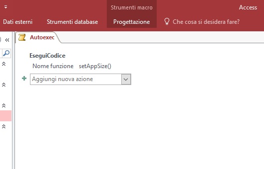

    Public Function setAppSize()
    ShowWindow hwnd:=Application.hWndAccessApp, nCmdShow:=SW_MAXIMIZE
    'ShowWindow hwnd:=Application.hWndAccessApp, nCmdShow:=SW_RESTORE
    End Function
    richiamando la funzione "setAppSize" tramite la "macro Autoexec":
