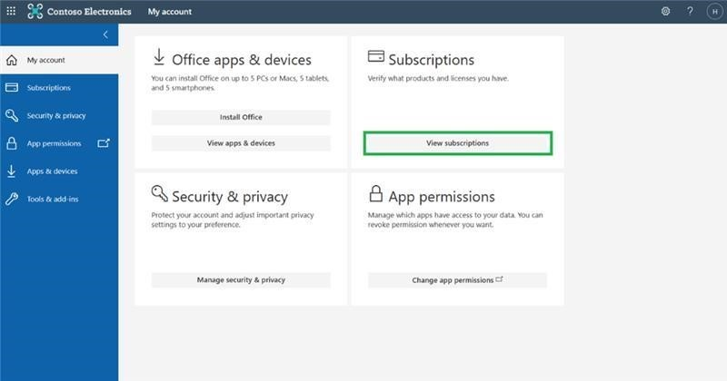

    1/ What type of Microsoft 365 subscription do you have?  You can check this yourself by signing in here: My account    
    User's image
    2/ If possible, could you share a screenshot showing the subscription associated with your account?

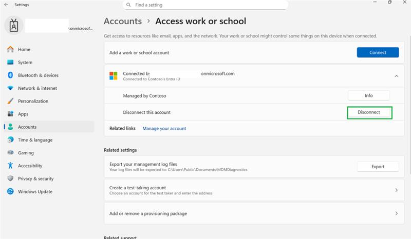

    Clear Office Credentials:

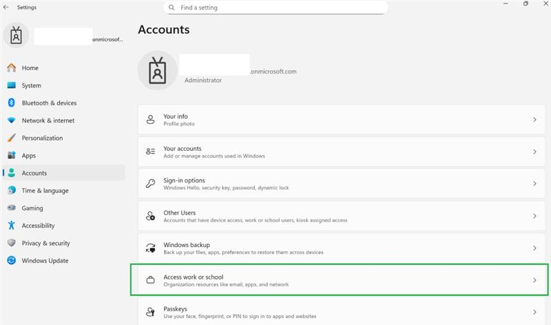

    • Remove the Work Account:
    • Go to Settings > Accounts > Work or School Account, select your account, and choose Disconnect.    User's image User's image

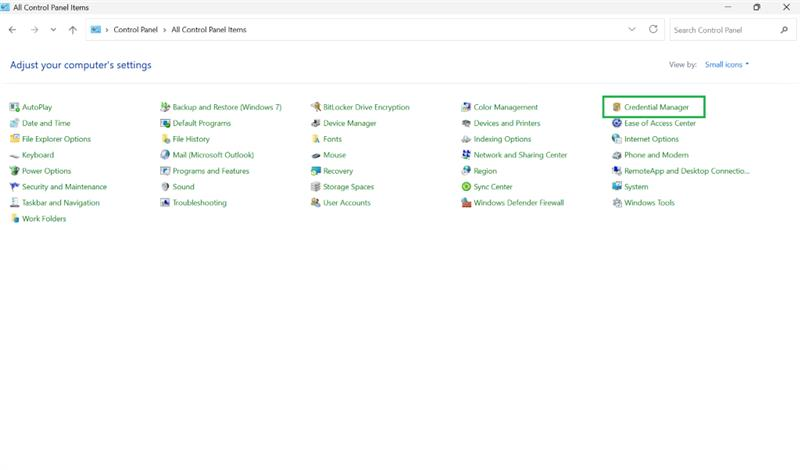

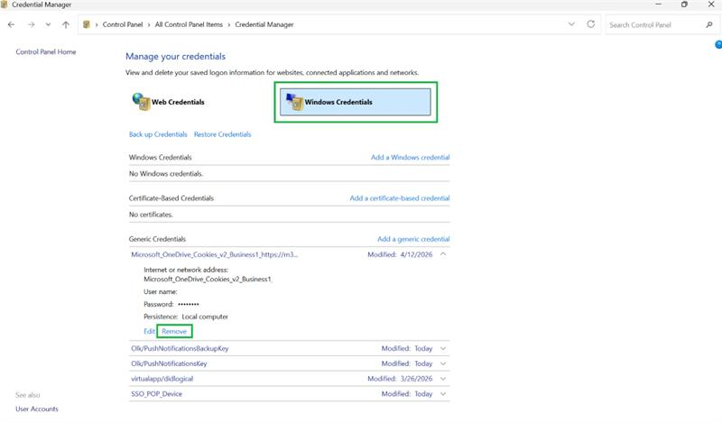

    Clear Credentials:
    • Head to Control Panel > Credential Manager and remove any cached Microsoft 365 or Office credentials.   User's image User's image
    • Try Re-adding the Account:
    • Once everything’s cleared, go back to Settings > Accounts and re-add your work account.

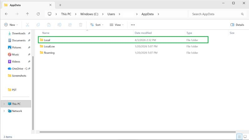

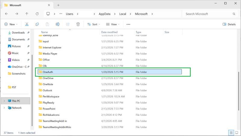

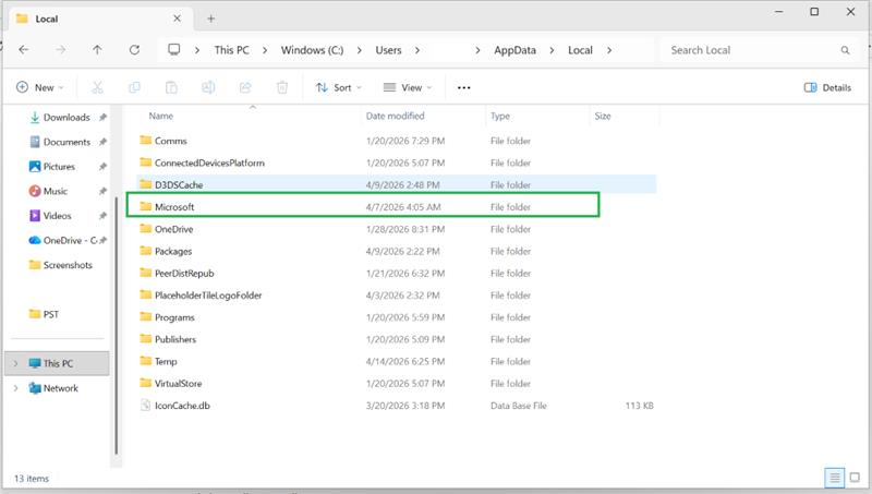

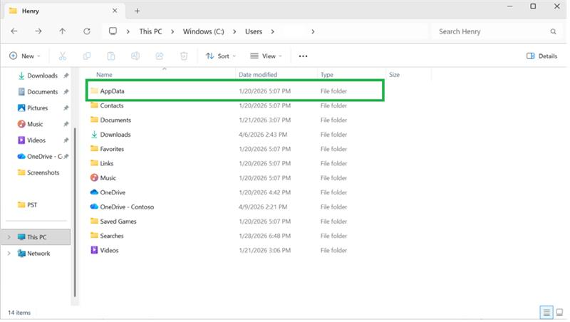

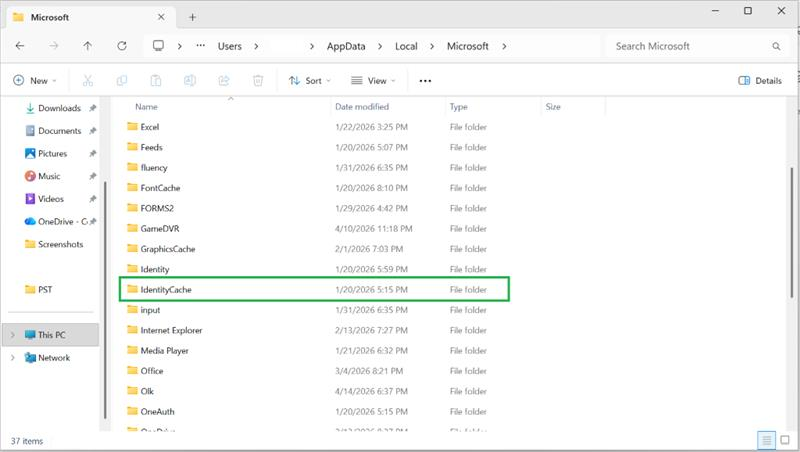

    Locate the Microsoft directory  Navigate to:
    • C:\Users<YourUserName>\AppData\Local\Microsoft  User's image User's image User's image
    • Delete the IdentityCache folder  User's image

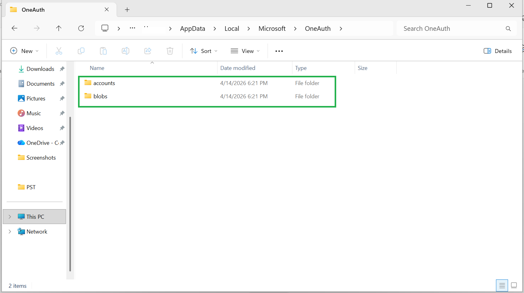

    • Open the “OneAuth” folder. Inside, you’ll typically find subfolders like “blobs” and “accounts,” each containing information about your sign-in sessions.   User's image
    • Delete the “blobs” and “accounts” folders  User's image
    • Restart an Office app and sign in again

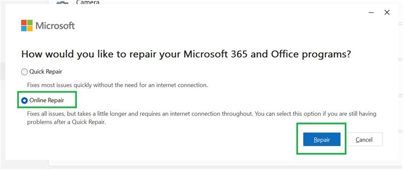

    Repair Office

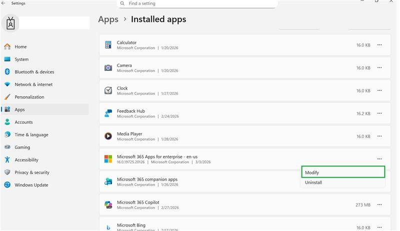

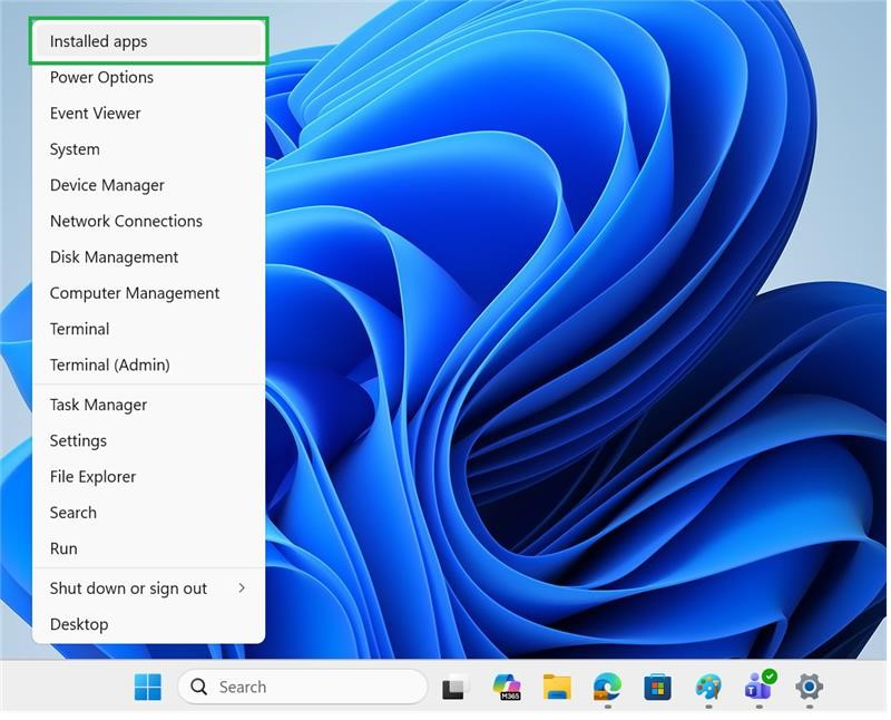

    • Right-click the Start button (lower-left corner) and select Installed apps on the pop-up menu.    User's image
    •  Select the Microsoft 365 or Office product you want to repair, click the ellipses, and select Modify.    User's image
    • If you see a notification that say " allow the change on your device" click yes. Then select online repair    User's image
