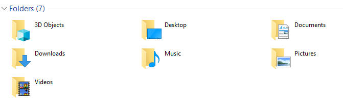

i merged my downloads folder and C:\Users\bob how do undo it
Anonymous
2025-02-15T03:33:40+00:00
i moved my downloads folder and documents folder to a diffrent drive then when i tried to move it back i messed up and made it the user profile folder instead of in the folder. i cant change location nor can i restore default.

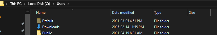

  1. Anonymous
    2025-02-15T05:09:20+00:00
    my user file is still a downloads folder
    when i open the folder this is the directory
    and i cant just rename it back, i have a downloads folder in that folder and i belive to work but the issue is that i want my user file to go back to normal
