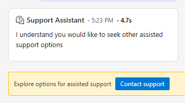

    • Open the Surface app on the laptop, select Help & support > Get help.
    • Or reach out to the seller if you purchased from retailer or third-party service.
    • Another path is to go through Contact Us - Microsoft Support
      • Enter / choose an issue > click Get Help to make a request
      • Scroll down > Contact Support (if the option is available)
      • Or click Ask our Support Assistant instead and follow guidance
      • If the issue persists, specifically state in the chat box that you need direct help.
      • The Contact Support button should appear now > click it > select the chat in browser option.
    User's image
    Note: The support contact team only works at certain times, so if the last window shows that it's unavailable, try opening it again the next day. If you prefer phone support, you can leave a phone number. This way, they can call you and help you.

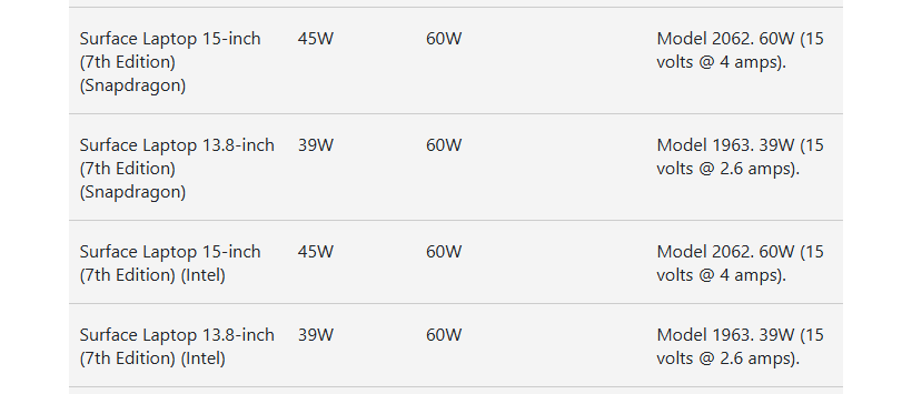

    In the other case that it came from another device or was purchased separately, please check the Output rating on both the 1625 and 1706 chargers. If the 1625 is below the 1706, it is not suitable for this laptop. If the numbers are the same, then there might be something wrong with the charger.
    User's image
    Overall, the Model 1625 charger is currently not working as it supposed to, so the best option would be a replacement. If it didn't come together with the laptop, you should find and purchase a compatible Microsoft or Microsoft-licensed charger.
