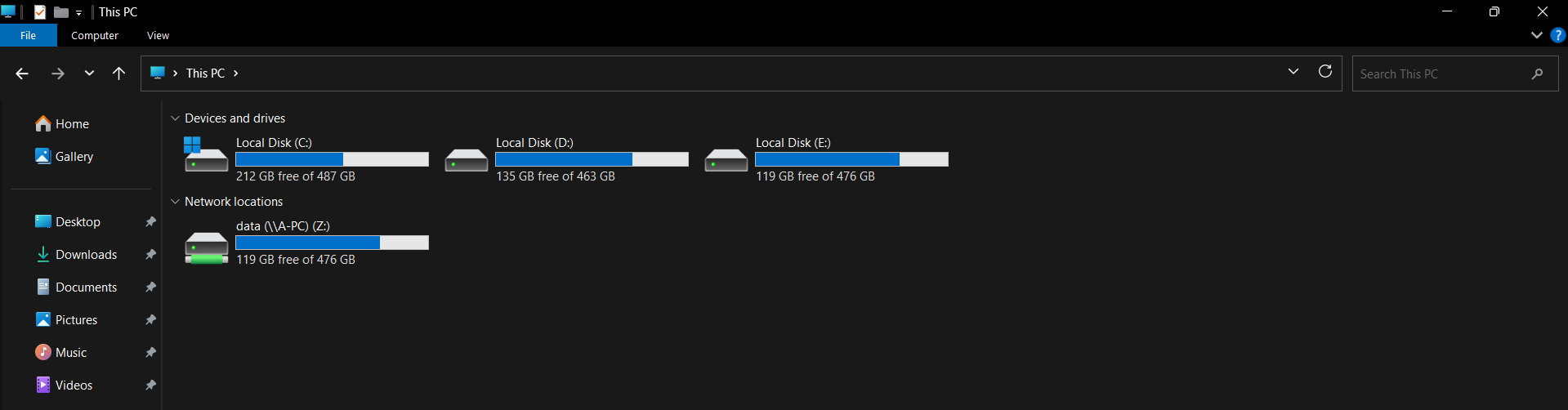

File Explorer has reverted from the modern Windows 11 interface (tabs, modern command bar) to the legacy/classic appearance. The exact onset time/date could not be reliably established — system log retention on this device does not extend far enough back to confirm it, and recollection has been inconsistent. This report documents confirmed diagnostic findings rather than asserting a specific root-cause update.
Environment
  • OS: Windows 11, version 25H2, build 10.0.26200.9550
  • Local/non-Entra-joined PC
  • Not currently enrolled in the Windows Insider Program (WindowsSelfHost\Applicability returns empty)
Possible related prior occurrence
A closely matching symptom — modern Explorer UI failing to load, tabs missing, following a Windows Update install, with a ViVeTool feature-flag reset attempted as a fix — was previously reported on 2026-09-11 on build 26300.9539 (Windows 11 26H2, Insider Release Preview channel). It has not been confirmed whether that report was from this same device; it's noted here in case it's relevant, since the failure pattern (modern components present, legacy UI rendered, no fix from cache-clear/SFC/ViVeTool reset) is otherwise identical.
What is confirmed
  • Symptom: File Explorer shows no tab bar and a legacy-style command bar instead of the modern Windows 11 interface.
  • Candidate updates in the relevant window on this device: KB5129195 (build 26200.9457, OOB, 2026-09-14) and KB5124010 (2026-09-24). Neither has been conclusively confirmed or ruled out as the trigger, due to onset-timing uncertainty.
  • it started before updating to KB5124010

  1. taha khalid 30 Reputation points
    2026-10-01T22:39:22.67+00:00
    I think I found the cause
    It was due to removo AI github scripts
    Breaking explorer
    It seems more AI stuffs been introduced into explorer
    So we should wait for better ai remover scripts without causing this problem
    They make debloating harder

  3. Horace Wiggins 535 Reputation points
    2026-09-29T12:44:39.5633333+00:00
    Do you have this showing in Windows 11 File Explorer?
    User's image
    If it's not there then look at this article. This is an answer that is already provided, and should help answer this topics question!
    https://dellenny.com/how-to-enable-tabs-in-file-explorer-in-windows-11/
