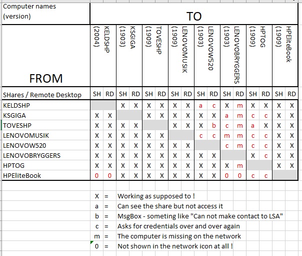

    I now tried the method on the LENOVOBRYGGERS and rebooted !
    I can only try FROM KELDSHP and KSGIGA today because the other are occupied - but NO DIFFERENCE from the table I posted earlier.
    The 'a' is a MsgBox telling me I have NO RIGHTS to access, contact the Administrator - but I just checked it again - ALL have full rights on these shares !
    I have tried "sfc /scannow" from the CMD and NOTHING wrong was found !

    2020-09-28T10:40:54+00:00
    Now I've done this on the 2004 machine ONLY and I beleave that as long as the "Network discovery" WONT stay ON ... that machine is NOT configured the right way ... right ?
    Isn't that the FIRST problem to solve ?

    2020-09-25T12:43:16+00:00
    Here is the sheet showing WHO can see WHO in the network:
