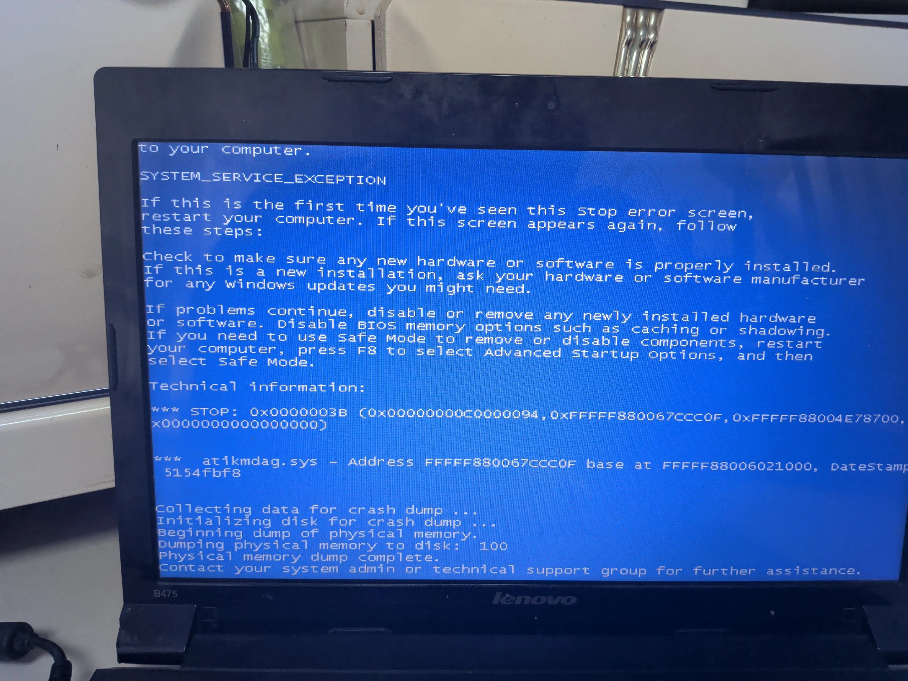

Lenovo B475Windows 7电脑安装驱动就蓝屏:0x0000003B
增尧 贾 25 信誉分
2026-08-23T02:50:32.9366667+00:00
就是这样如果卸载了驱动可以正常启动然后安装驱动蓝屏,不安装驱动就会卡的要命请问有没有解决方案。 这个老牧师不到50字符不能发xxxxxxxxxxxxxxxxxxxxxxxxxxxxxxxxxxxxxxxxxxxxxxxxxxxxxxxx xxxxxxxxxxxxxxxxxxxxxxxxxxxx xxxxxxxxxxxxxxxxxxxxxxxxxxxx xxxxxxxxxxxxxxxxxxxxxxxxxxxx sbxxxxxxxxxxxxxxxxxxxxxxxxxxxx xxxxxxxxxxxxxxxxxxxxxxxxxxxx

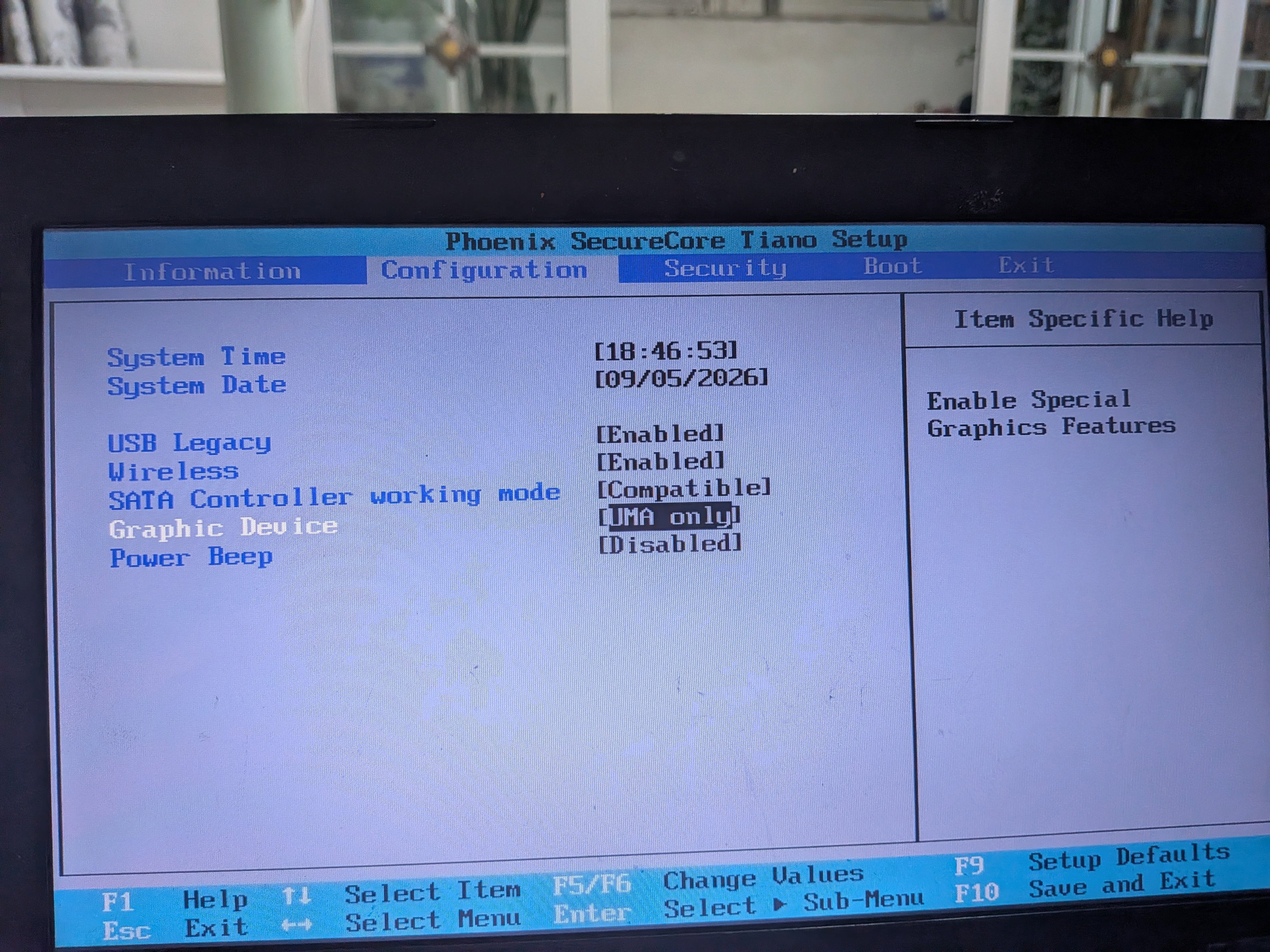

谢谢各位,问题已解决,可能是老化等,独立显卡出问题了,在BIOS SETUP把Graphic Device改成了UMA only,重新安装驱动即可
Thank you everyone, the problem has been solved. It was probably due to aging or other issues with the dedicated graphics card. Changing the Graphic Device to UMA only in the BIOS setup and reinstalling the driver resolved the problem.

  1. 增尧 贾 25 信誉分
    2026-08-24T00:56:29.3133333+00:00
    抱歉我写错了,是3B,不好意思
