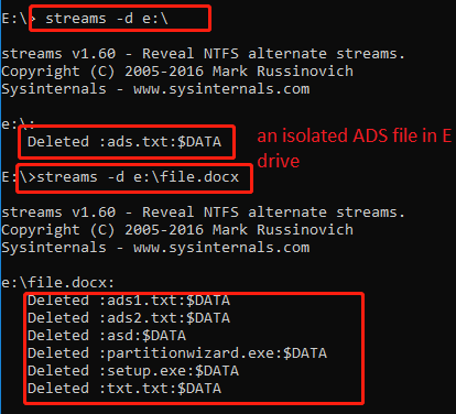

In this part, I will show you how to wipe Alternate Data Streams using streams.exe. Here is the guide:
- Make sure the Alternate Data Streams files have stopped running.
- Download Streams.exe tool from Microsoft and then unzip it.
- Open the streams folder and move streams app to the root directory of the partition where you want to delete the streams files.
- Run command “streams -d + host file path” This command will delete all ADS files lodged in the host file.After finding ADS files, you can delete these NTFS Alternate Data Streams files through the following 3 ways:
- Delete the host file directly.
- Move the host file to a non-NTFS partition like FAT32, FAT, etc.
- Use Streams.exe offered by Microsoft to delete streams.
Tip: 1. The dir /r command won’t display isolated ADS files. 2. To delete the isolated ADS file, you need to delete its upper directory. But Streams.exe tool can help you delete the isolated ADA file more easily. In the above picture, I have created an isolated ADS file under E directory. You can see the command *streams -d e:* has deleted the isolated ADS file.
