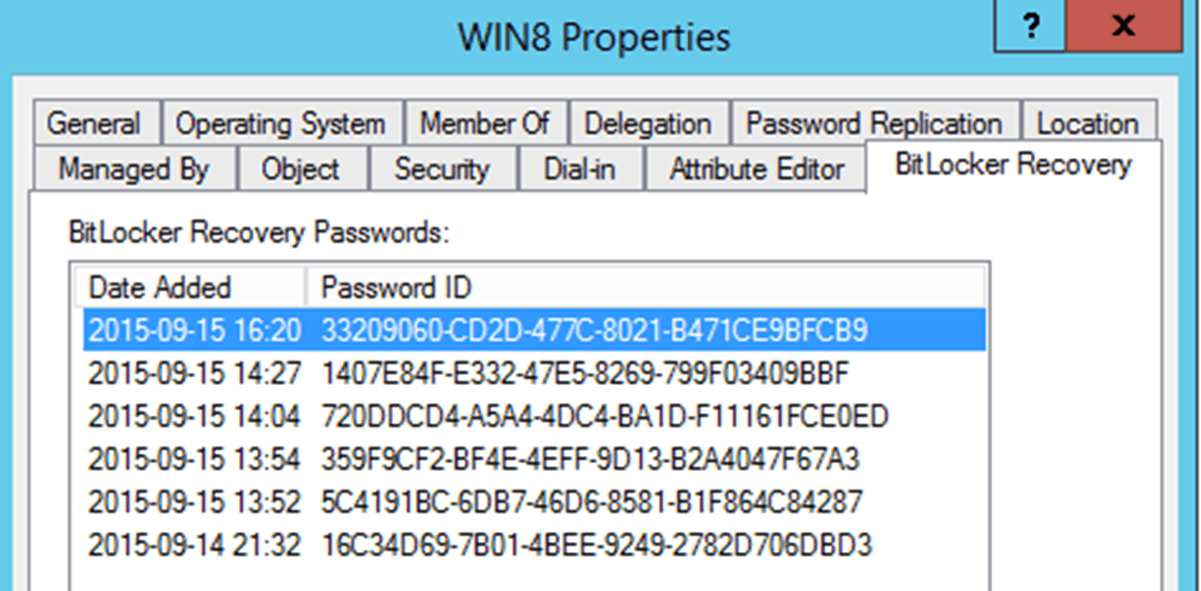

    • Active Directory (AD)
    • Azure Active Directory (AAD)
    • Microsoft Account
    • MBAM
    • 3rd management application
    • Other methods like notepad/pdf/USB

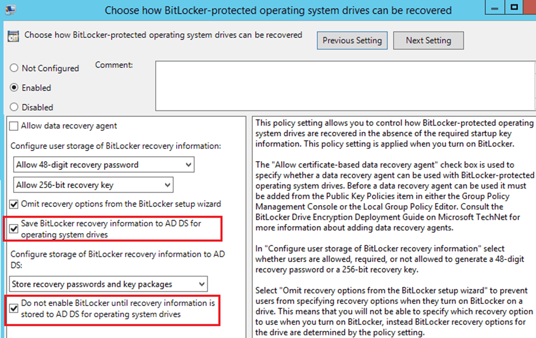

    1.If you are logged in with ad account,You need to first ensure that the following policies are configured.

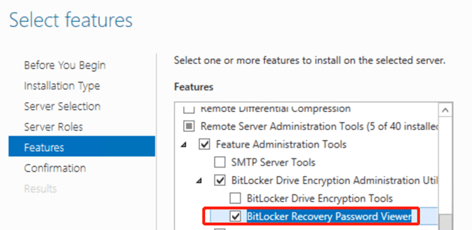

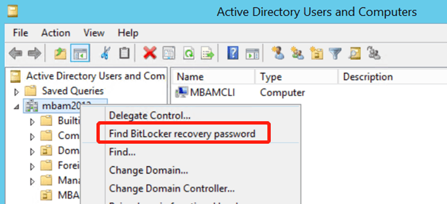

    Please install the following feature on ad dc side, then open ADUC and look for the recovery key.
    Domain Administrator privileges are required or delegated permissions must have been granted by a domain administrator.
    Normal users will not see the recovery key and cannot search for it.
