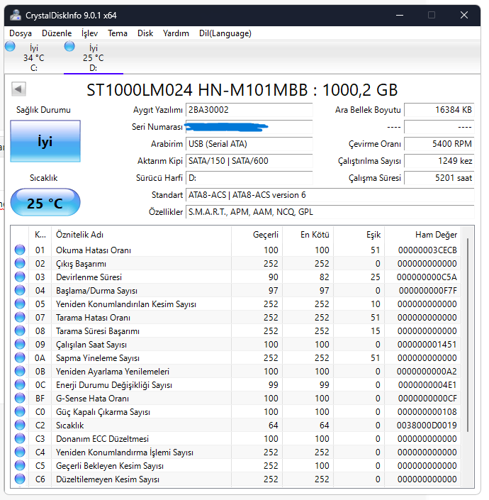

  1. Anonim
    2023-06-23T06:40:25+00:00
    Yes externel drive is D: disk. I take out the HDD when I'm not using it for a few days, I just plug it in when necessary and I've never had a blue screen. Thanks for your help, we can reach a definite conclusion that I will buy a new SSD disk and reset my computer to factory settings.

  2. Igor Leyko 112.4K Saygınlık puanı Bağımsız Danışman
    2023-06-22T22:48:14+00:00
    Is the external drive - D: disk? If yes, the problem may be in some USB driver. Please check if the problem exists during clean boot. https://support.microsoft.com/tr-tr/topic/how-t...

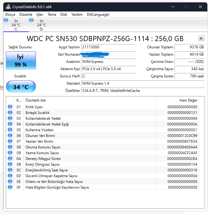

  3. Anonim
    2023-06-22T19:55:53+00:00
    I did a full scan to the ssd, it said no problems were detected, the dashboard software. Now you think the problem is hdd?

  4. Igor Leyko 112.4K Saygınlık puanı Bağımsız Danışman
    2023-06-22T19:08:07+00:00
    If I understoos you correctly, the problem may be realted with an external HDD. Please check its health.
    By the way - SSD has one replaced sector already and this is not a good sign. Please run a full test in Western Digital Dashboard tool.

  5. Anonim
    2023-06-22T08:19:08+00:00
    My ssd health is 99% and it looks normal but no exact data for hdd it just writes fine
