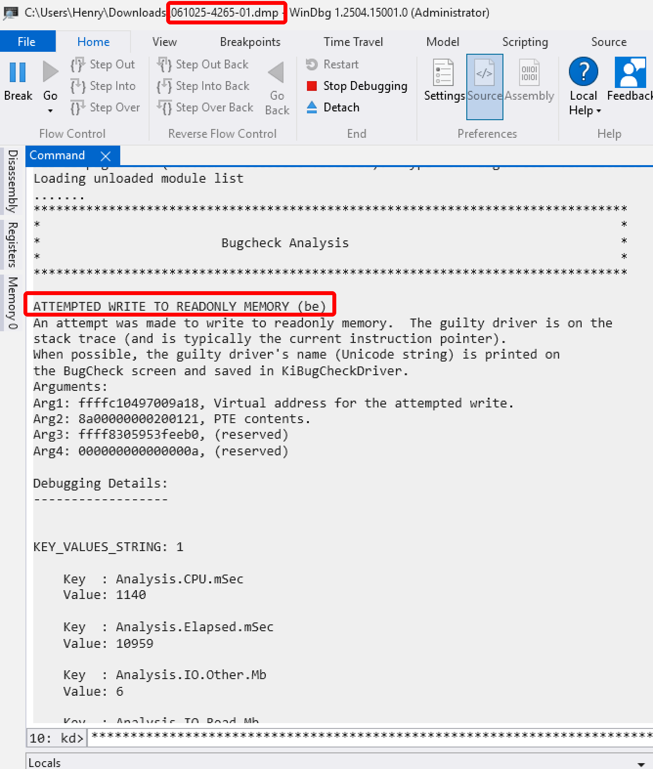

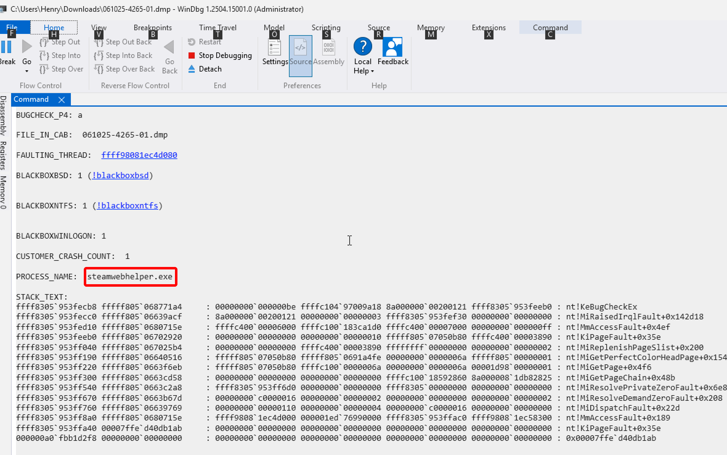

    Thank you for providing the minidump file and your system specifications. I have analyzed the crash report, and I want to share my insight about this issue.
    Combined Analysis of Both Crash Dumps
    Dump Analysis (061025-4265-01.dmp):Kullanıcının resmi
    Kullanıcının resmi
    • Bugcheck Code: ATTEMPTED_WRITE_TO_READONLY_MEMORY (be)
    • Failing Process: steamwebhelper.exe
    • Root Cause: A critical error within the Windows Kernel's memory management functions.
    Diagnosis: When a crash occurs deep inside the Windows memory manager and does not blame a specific driver (like your graphics or network driver), it points overwhelmingly to a hardware-level problem with your RAM (memory). The RAM is likely unstable, causing it to feed corrupt data to the operating system, which then crashes when trying to manage it.
    Since you have already confirmed the BIOS is updated and the CPU is compatible, we can now focus entirely on resolving the RAM instability. Please follow these steps in order.
