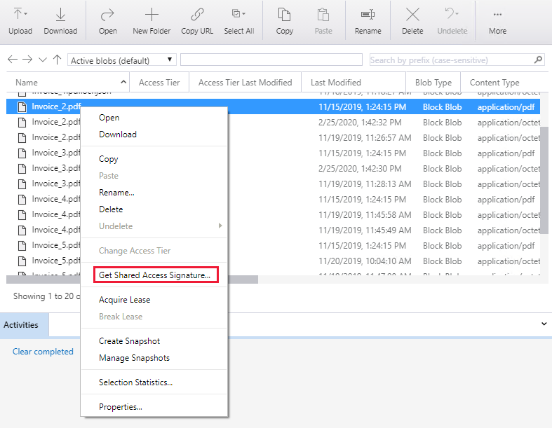

Here you'll need to provide the URL of a form that has the same type as the forms you trained with. For testing purposes, you can use one of your training forms. If you followed the cURL quickstart, your forms will be located in an Azure Blob Storage account. Open Azure Storage Explorer, locate a form file, right-click it, and select Get Shared Access Signature. The next dialog window will provide a URL and SAS token. Enter these strings in the "formUrl" and "formSasToken" fields of your request body, respectively.
