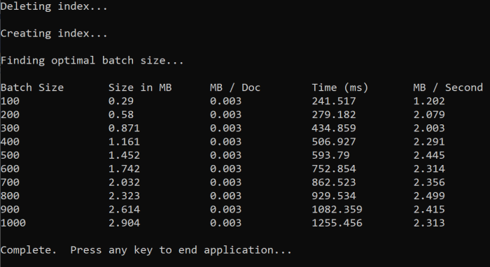

The function requires a SearchClient plus the number of tries you'd like to test for each batch size. Because there might be variability in indexing times for each batch, try each batch three times by default to make the results more statistically significant.
await TestBatchSizesAsync(searchClient, numTries: 3);
When you run the function, you should see an output in your console similar to the following example:
Screenshot of the output of test batch size function.
Identify which batch size is most efficient and use that batch size in the next step of this tutorial. You might see a plateau in MB/s across different batch sizes.

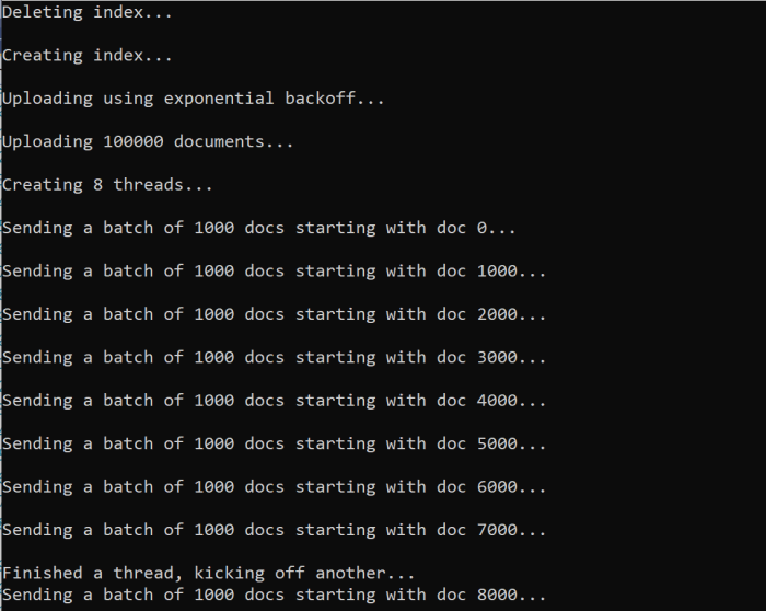

From here, wrap the exponential backoff code into a function so it can be easily called.
Another function is then created to manage the active threads. For simplicity, that function isn't included here but can be found in ExponentialBackoff.cs. You can call the function using the following command, where hotels is the data we want to upload, 1000 is the batch size, and 8 is the number of concurrent threads.
await ExponentialBackoff.IndexDataAsync(searchClient, hotels, 1000, 8);
When you run the function, you should see an output similar to the following example:
Screenshot that shows the output of an index data function.
When a batch of documents fails, an error is printed indicating the failure and that the batch is being retried.
[Batch starting at doc 6000 had partial failure]
[Retrying 560 failed documents]

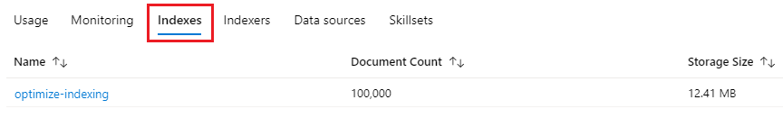

After the function finishes running, you can verify that all of the documents were added to the index.

Azure portal
In the Azure portal, from the left pane, find the optimize-indexing index in the Indexes list.
Screenshow that shows a list of Azure AI Search indexes.
The Document Count and Storage Size are based on the Get Index Statistics API and can take several minutes to update.
