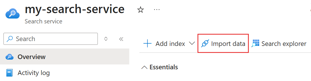

When you're ready to create an indexer on a remote search service, you need a search client. A search client can be the Azure portal, a REST client, or application code that instantiates an indexer client. We recommend the Azure portal or REST APIs for early development and proof-of-concept testing.
Go to your search service in the Azure portal.
Choose from the following options:
Import data: This wizard creates all of the required elements, including the indexer. Other approaches require a predefined data source and index.
Add indexer: A visual editor for specifying an indexer definition.
