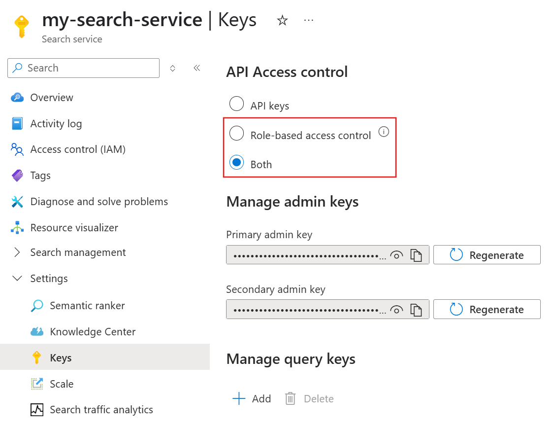

  1. Go to your search service in the Azure portal.
  2. From the left pane, select Settings > Keys.
  3. Select Role-based access control or Both if you need time to transition clients to RBAC.
    Screenshot of the access control options in the Azure portal.

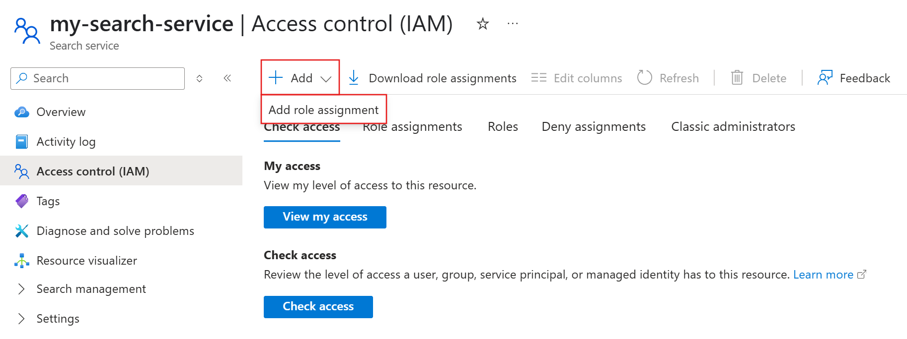

  4. From the left pane, select Access control (IAM).
  5. Select Add > Add role assignment.
    Screenshot of the dropdown menu for adding a role assignment in the Azure portal.
  6. Assign the Search Service Contributor role to your user account or managed identity.
  7. Repeat the role assignment for Search Index Data Contributor.
