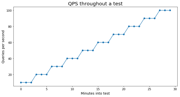

- The test begins at
Xqueries per second (QPS) for 180 seconds. This was usually 5 or 10 QPS. - QPS then increased by
Xand ran for another 180 seconds - Every 180 seconds, the test increased by
XQPS until average latency increased above 1000 ms or less than 99% of queries succeeded.
The following graph gives a visual example of what the test's query load looks like:

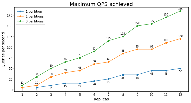

S1 Performance
Queries per second
The following chart shows the highest query load a service could handle for an extended period of time in terms of queries per second (QPS).

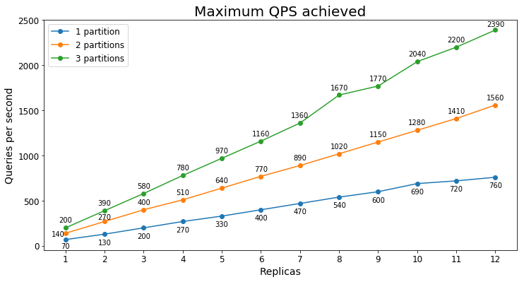

S2 Performance
Queries per second

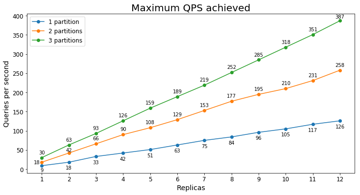

S3 Performance
Queries per second
In this case, we see that adding a second partition significantly increases the maximum QPS but adding a third partition provides diminishing marginal returns. The smaller improvement is likely because all of the data is already being pulled into the S3's active memory with just two partitions.
