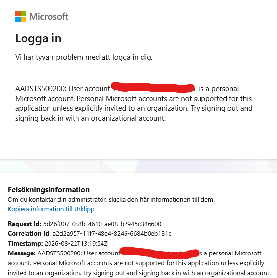

Trying to use get help application to solve me activating windows after swapping damaged parts in my PC.
But when it asks me to logg in it leads to AADSTS500200, saying my account is personal and can't access this support.
My account is personal, nothing to do with any work or school, so thus you can't use get help system?

Okej Jag löste Get help / Få hjälp problemet:
Tog bort programmet med Powerchell som admin med:
Get-AppxPackage Microsoft.GetHelp | Remove-AppxPackage
Och installerade det på nytt från https://apps.microsoft.com/detail/9pkdzbmv1h3t?hl=sv-SE&gl=IN
Då funkade få hjälp / get help appen att logga in på igen utan problem code: AADSTS500200.
