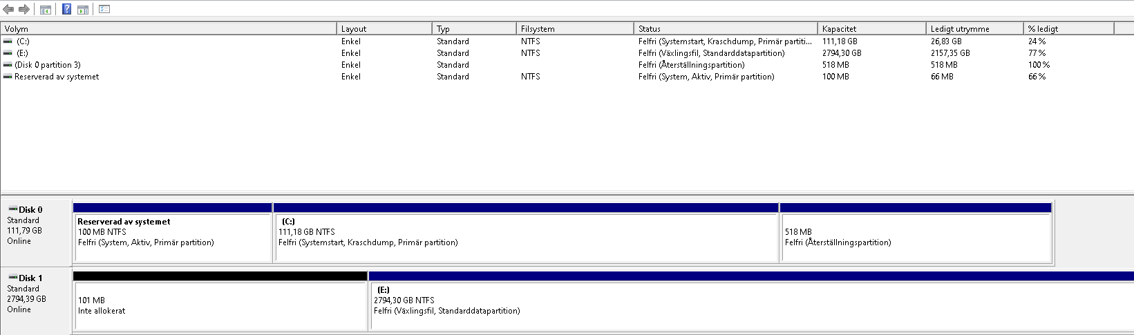

    I noticed the disk 1 now has Växlingsfil (Shift file, or paging file) in its description after removing the EFI system. I'll add a screenshot of disc management along with diskpart error message.
    2022-04-14T17:02:27+00:00

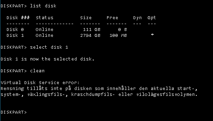

    Just incase somehow there would be any windows files on disk 1 i decided to clean it with diskpart and i got this message:
    Virtual Disk Service error:
    Cleaning is not allowed on the disk that contains the current boot, system, shift file, crash file, or hibernation file volume.
    I am so confused about why this is happening. When this happened today and I couldn't boot at first, I waited on windows logo with spinning dots for about 20 minutes and it booted. But no HDD was found. Then I simply turned of my computer, unplugged the power cable and change SATA port, plugged power cable back in and it started fine again and I can use the HDD. It started without problem this morning.

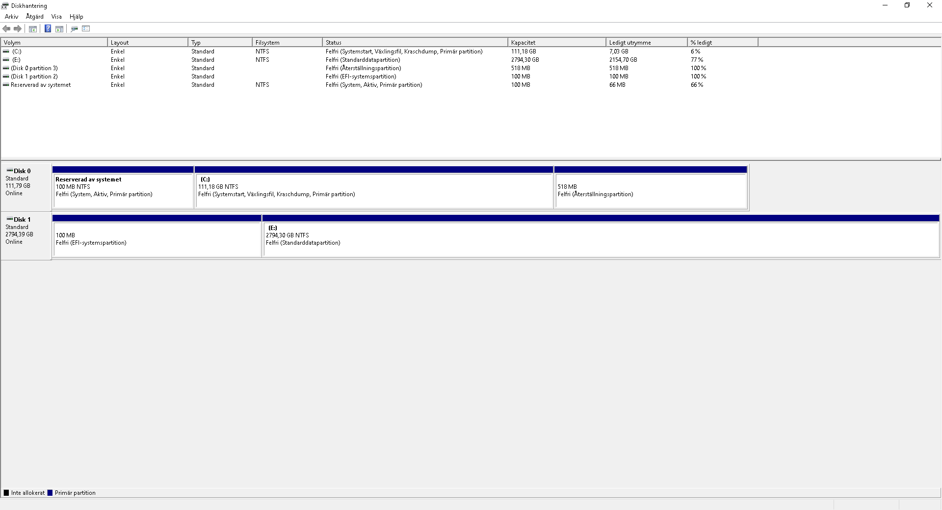

    The problem could be the second EFI System partition, on Disk 1.
    Is DIsk 1 presently or previously a Windows drive? Are you using it in Dual boot that is controlled by BIOS boot menu, or does it have a WIndows Dual Boot menu screen?
    If DIsk 1 is no longer a WIndows installation you use, it should have had the data moved off and been deleted in Disk management, or to even better assure no future problems wiped with Diskpart Clean Command to clear boot code that should not exist on a data drive.
    If you had wiped or deleted the E partition first then you can just delete the EFI System off of Disk 1. But first make sure it's not booting the present install by unplugging it's data cable to test starting Windows on Disk0. If it starts on it's own then you can delete the Disk 1 EFI System partition in Disk Management, or if it refuses then use the EISA command here to delete a System partition: https://techjourney.net/delete-and-remove-prote...
    If the E partition still has Windows files then you are best off by far moving the data off to wipe the drive with Clean Command and then reformat as a data drive:
    http://www.howtogeek.com/235824/how-to-clean-a-...
    To surgically remove the Windows folder requires using Take Ownership shortcut on all parent and child folders, and still leaves code that can interfere:
    http://www.howtogeek.com/howto/windows-vista/ad...
    Based on the answers you post back I may have other suggestions.

    I forgot to mention that I already did a full disk check from Command Prompt and no problem was found. I tried another SATA port now with the same cable and it works again. Here is a screenshot from Disk management
    As of now everything works fine, I can see my HDD and use it without any problem. We will see if this happens again in a few days.
