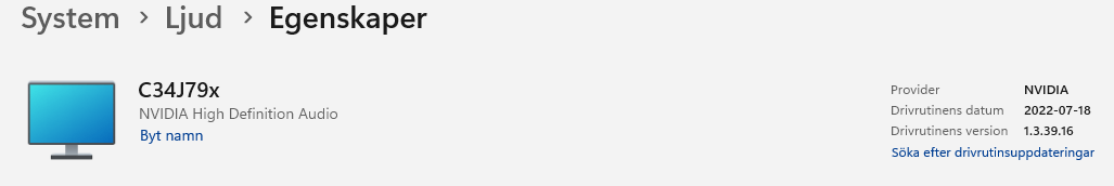

    My screen which is connected to a HDMI port has built in speakers and using those it works without delay as far as I can see. I will continue using this configuration to confirm that it works. But it looks like the driver update didn't affect the Audio. See below screen shot for Driver date and version.

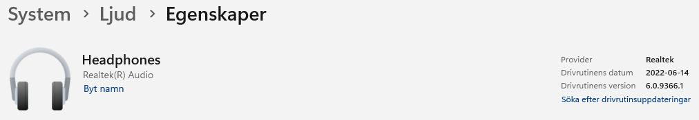

    Regarding the Realtek (R) Audio driver my system says it is the latest driver. I have tried to find new driver on the Realtek homepage but haven't suceeded. Their homepage isn't the easiest one to navigate. Can you help?
    This is how the Nvidia configuration looks like:
    This is the Realtek:

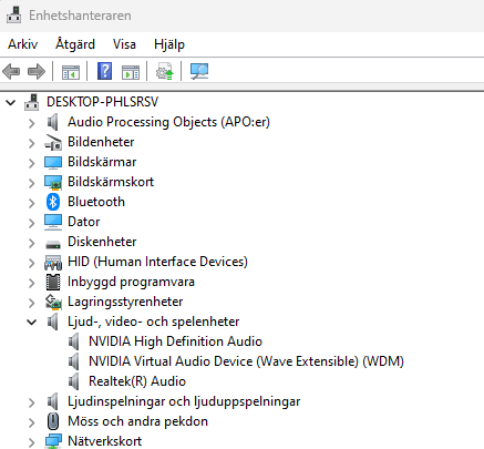

    This is how in looks in the Device manager:

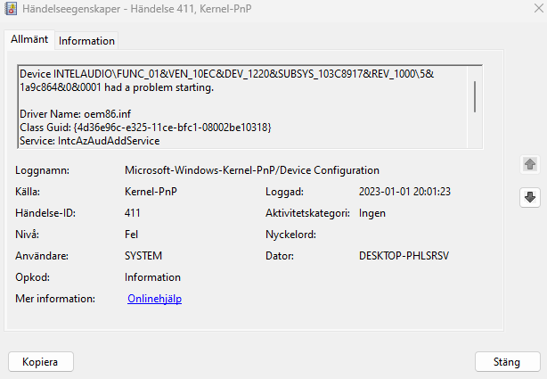

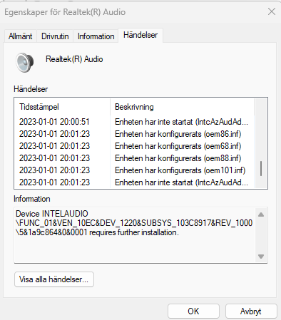

    On Events for Realtek it says "requires further installation".
    I also found this. If I scroll down it also says "Problem Status: 0xC00000E5"

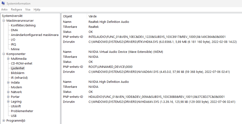

    Here is the System information for Realtek High Definition Audio (and for Nvidia).
    Nvidia output is OK and there is now delay in reaching selected volume.
    The problem is for Realtek which feeds 3.5 mm jacks for speakers and headphones.
