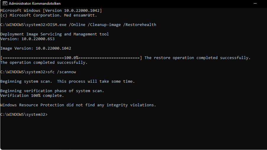

    Hi Vitrix,
    Thanks for updating me.
    Since the Malwarebytes and DISM command did not find anything on your computer, most probably it is false positive. However, try to Start your computer in Safe Mode with Networking and then scan for the file to see if it would be deleted or not:
    https://support.microsoft.com/en-us/windows/sta...

    2022-10-12T11:54:19+00:00
    Hello there... thanks for your quick respond sadly malewarebytes cant find the virus as i stated above i have tryed every single software out there..
    sadly this did not work either it seem like....
