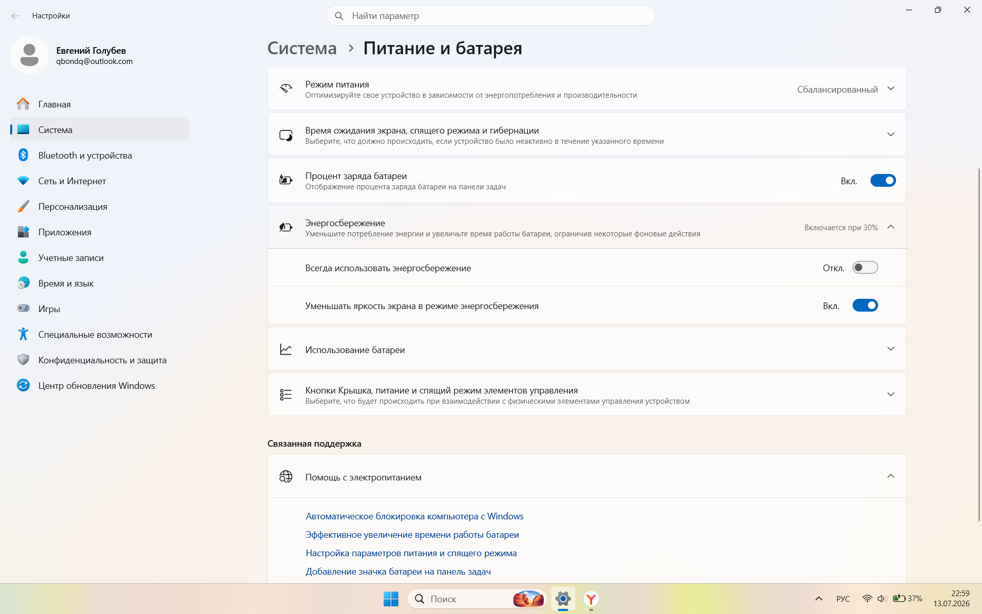

Здравствуйте.
Ноутбук Infinix Inbook Y3 Max, Windows 11 (версия 25H2, сборка 26200.8655).

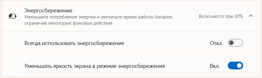

Настройки - Система - Питание и батарея - в разделе Энергосбережение пропала вкладка выбора процента заряда, при котором включается энергосбережение. Я выставлял 10%, теперь стоит 30% и нельзя поменять. Как теперь выставить 10%?110011

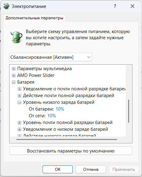

    Hi,
    That option was intentionally removed when Microsoft replaced the old Battery Saver feature with the newer Energy Saver system. Unlike Battery Saver, which activated at a specific battery percentage, Energy Saver continuously manages background activity and power consumption to improve efficiency. Because it operates dynamically rather than relying on a set threshold, the battery percentage dropdown is no longer available in the main Settings screen.
    If you'd like to restore the classic behavior, you can still set a custom battery percentage threshold through the legacy Power Options menu. To configure battery thresholds to activate energy saver through the legacy settings:
    • Press Windows key + R.
    • Type powercfg.cpl and press Enter.
    • Click Change plan settings next to your active power plan
    • Select Change advanced power settings
    • Expand Battery near the bottom of the list
    • Adjust the Low battery level setting to your preferred percentage.
