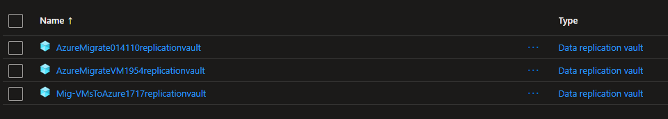

Tenho alguns recursos que não consigo deletar de forma alguma via portal, Powershell ou Azure CLI. Preciso deletar todos esses recursos, pois era relacionado a uma POC que já finalizamos.
São recursos do tipo Data Replication Vault.

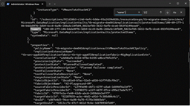

    1. Retrieve the protected items:
    Invoke-AzRestMethod -Method GET -Path "/subscriptions/<subscriptionId>/resourceGroups/<resourceGroupName>/providers/Microsoft.DataReplication/replicationVaults/<replicationVaultName>/protectedItems?api-version=2024-09-01"
    1. Locate the protected item IDs by searching for "name": in the output.
    Example: ==image_0==.png

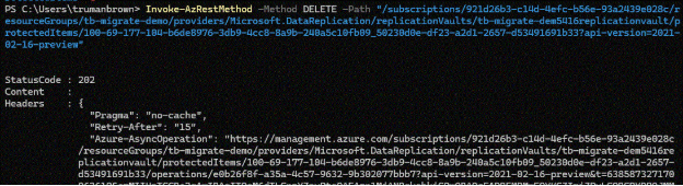

    1. Delete the protected items using their GUIDs:
    Invoke-AzRestMethod -Method DELETE -Path "/subscriptions/<subscriptionId>/resourceGroups/<resourceGroupName>/providers/Microsoft.DataReplication/replicationVaults/<replicationVaultName>/protectedItems/<protectedItemGUID>?api-version=2024-09-01"
    Example:
    1. If the deletion fails, use the ForceDelete option to forcefully remove the protected items:
    Invoke-AzRestMethod -Method DELETE -Path "/subscriptions/<subscriptionId>/resourceGroups/<resourceGroupName>/providers/Microsoft.DataReplication/replicationVaults/<replicationVaultName>/protectedItems/<protectedItemGUID>?api-version=2024-09-01&ForceDelete=True"

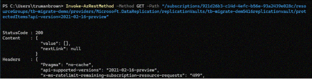

    1. Verify the deletion by running the initial GET command again to ensure the protected items are removed.
