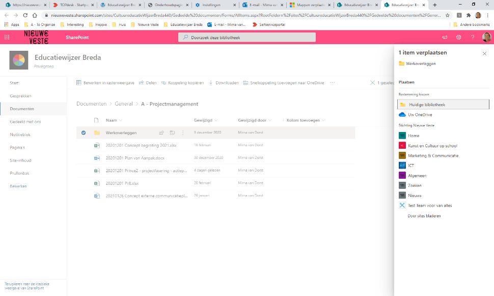

    I am curious to know whether you can find the solution. Underneath here is the prinscreen. I want to move a folder from the right (Werkoverleggen) to another Team. So I choose 'move to' from the three dots right from the folder name. Then the list on the right appears. At the bottom of the list it says 'Door alles bladeren' (search everything) I have searched all Teams, but the Teams created from 2021 do not appear in this list at all. So I cant move folders to my newly created Teams...
