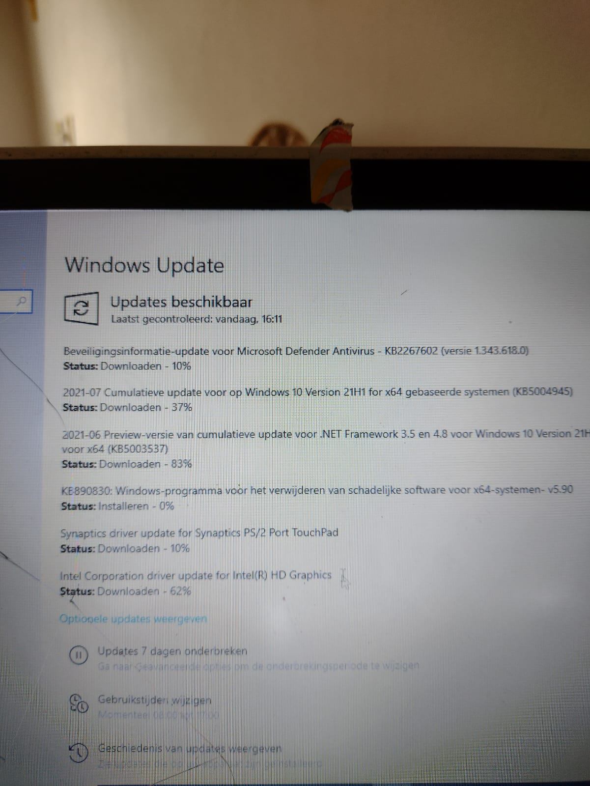

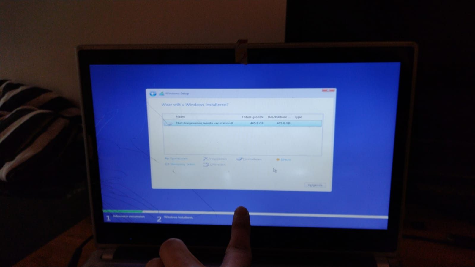

I have an old laptop (Acer aspire V5) that i reinstalled with windows 10, after installation everything seems normal but after a few minutes the screen is weirdly blurred, (picture 1 (I know the screen is cracked but it works fine see picture 2)) it looks like i have som sort of overlay with another screen, I also have a double mouse. I started it in safe mode and i dont have the issue.
I have tried reinstalling it, use another usb drive with a new windows setup on it but it still has the same issue. At first it seems to be working then after a while same problem. After some troubleshooting i found that if i don't connect to the internet the problem doesn't come up. I have tried stopping updates, to disable screen adapters in device manager but i can't seem to get it working. I think it might be a drive issue but am not sure. If anyone can help me out that would be great!

    Thanks for your reply, i have been trying to fix the issue using your method. However after a few failed attemts i found that after i try a system update the screen goes wild. I have taken a picture of the updates that were installing, and im quite sertain the screen goes when the last update (Intel Corporation driver update fot intel(R) HD graphics) is complete.
    When I connect to the network updates automatticly start dowloading and installing so i can't really try annything that requires internet. I have tried to download drivers on my other PC and installing them but that still hasn't worked. I don't have the original drivers that were on the PC, i don't have anny files or programs that i want to keep, i just need a clean install of windows. Do you maybe have another option i can try?
    EDIT:
    I have tried blocking updates from windows using services.msc and disabeling updates. ( I dont really need updates, its just an old laptop for playing some games) but still after i connect to the network within a few minutes the screen goes crazy.
