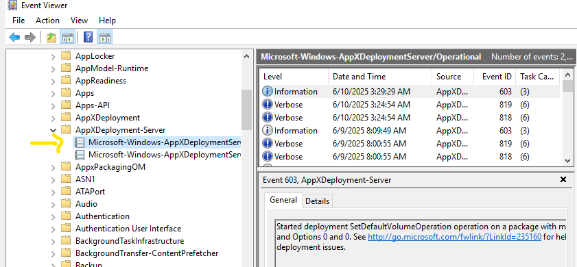

    1.Check Event Logs:
    • System Logs: Look for errors related to User Profile Service, disk I/O, or any other system-level issues around the time new users experience the problem.
    • Application Logs: Look for errors related to StartMenuExperienceHost.exe, ShellExperienceHost.exe, SearchApp.exe, or any other UWP applications.
    • Microsoft-Windows-AppXDeploymentServer/Operational logs: These logs are important for UWP app deployment and can show errors related to package registration. Afbeelding van gebruiker
