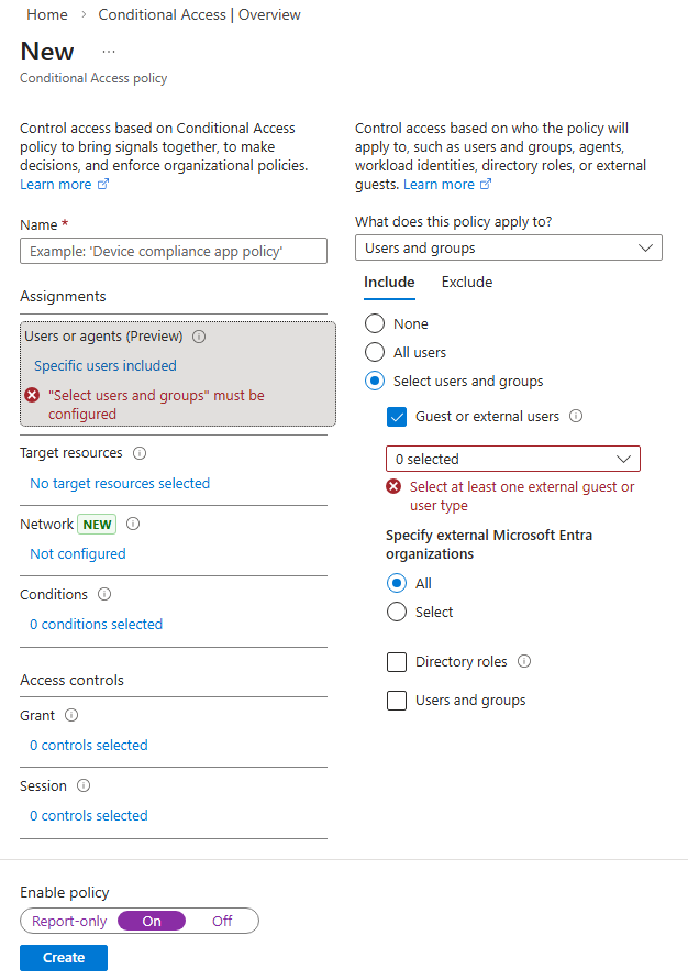

    • Go to Entra admin center, select Conditional Access and create a new policy.
    Brukerens bilde
    • Under Users, target all users except break‑glass accounts.
    Brukerens bilde
