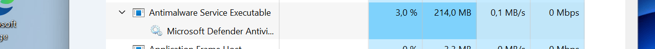

    edit: Bilde
    Here's another, clean, user account. This launches, and has maintained itself - across multiple boots, attempts to stop all the services, to exclude these orphaned commands -- I cannot do it. It launches and is maintained by the system/admin account, that I don't have access to. So now I'm down to picking out specific updates - which really won't work. Or reinstalling the OS from scratch -- which also won't work, for the same reason: this will again be launched by approved script through Windows Update.
    So now my laptop has been draining battery at an absurd rate for three days. It **** my work, it **** my spare time, and I do not understand why this is even here. This ranks so high on the obnoxiousness scale that it is amazing even for Microsoft. And I knew the guys who did RT. Why even do these scans this way?
    editer: So after deleting all exceptions to scans, reinstalling definition files, disabling quiet times, forcing the laptop to stay awake, forcibly completing a full scan, creating a new account to idle from, all of which it is unknown had any impact on this, the routine finally completed. Before ending, it "recovered" my power-profiles and enabled the high performance scan, invalidated my graphics driver, my chipset drivers, and the keyboard shortcut program and made sure to not recognize my screen driver. I have spent a very long time reinstalling the oem drivers, and putting things back to the way it was.
