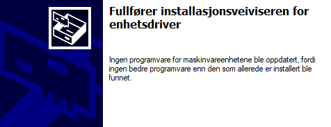

    (Translation: No driver was updated, since no update was found thats better than the one currently in use)
    (Translation: The best driver for the device is already installed)

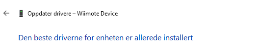

    I downloaded the windows 10 version from Gerrydoro, but upon opening the exe file it tells me the driver already is at the newest version. I also went into the Device Manager and checked for updates, but it also told me it was already at the latest version. Maybe i installed something wrong here but im pretty sure i did everything correctly.
    If you can't find anything, thanks for atleast helping me get a little further on trying to connect it :)

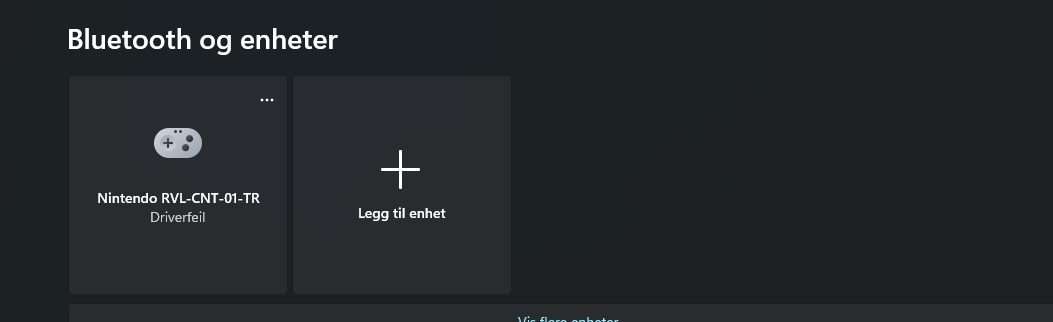

    I was able to get it added as it's own device, which is really good and thanks for the help on that, it then told me to restart my pc which i did. But now there's something wrong with the driver. I can't download the drivers Gerrydoro linked as there isn't any for windows 11 and im unsure if the windows 10 driver would work. How do i fix this? I'll try looking for it but im also asking here since that worked perfectly.
    Summary: Driver Error (written as "Driverfeil") in the screenshot)
