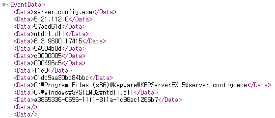

In Windows Event Viewer (Application Log), the following error is recorded:
사용자의 이미지
Faulting application name: server_config.exe
Version: 5.21.112.0 Faulting module name: ntdll.dll
Version: 6.3.9600.17415
Exception code: 0xc0000005
Fault offset: 0x000496c5
Application path: C:\Program Files (x86)\Kepware\KEPServerEX 5\server_config.exe
Module path: C:\Windows\System32\ntdll.dll
