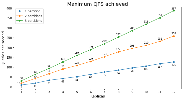

S1 Performance
Queries per second
The following chart shows the highest query load a service could handle for an extended period of time in terms of queries per second (QPS).
Query latency
Query latency varies based on the load of the service and services under higher stress have a higher average query latency. The following table shows the 25th, 50th, 75th, 90th, 95th, and 99th percentiles of query latency for three different usage levels.
| Percentage of max QPS | Average latency | 25% | 75% | 90% | 95% | 99% |
| 20% | 104 ms | 35 ms | 115 ms | 177 ms | 257 ms | 738 ms |
| 50% | 140 ms | 47 ms | 144 ms | 241 ms | 400 ms | 1175 ms |
| 80% | 239 ms | 77 ms | 248 ms | 466 ms | 763 ms | 1752 ms |

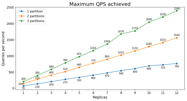

S2 Performance
Queries per second
Query latency
| 20% | 56 ms | 21 ms | 68 ms | 106 ms | 132 ms | 210 ms |
| 50% | 71 ms | 26 ms | 83 ms | 132 ms | 177 ms | 329 ms |
| 80% | 140 ms | 47 ms | 153 ms | 293 ms | 452 ms | 924 ms |

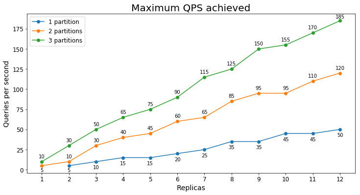

S3 Performance
Queries per second
In this case, we see that adding a second partition significantly increases the maximum QPS but adding a third partition provides diminishing marginal returns. The smaller improvement is likely because all of the data is already being pulled into the S3's active memory with just two partitions.
Query latency
| 20% | 50 ms | 20 ms | 64 ms | 83 ms | 98 ms | 160 ms |
| 50% | 62 ms | 24 ms | 80 ms | 107 ms | 130 ms | 253 ms |
| 80% | 115 ms | 38 ms | 121 ms | 218 ms | 352 ms | 828 ms |
