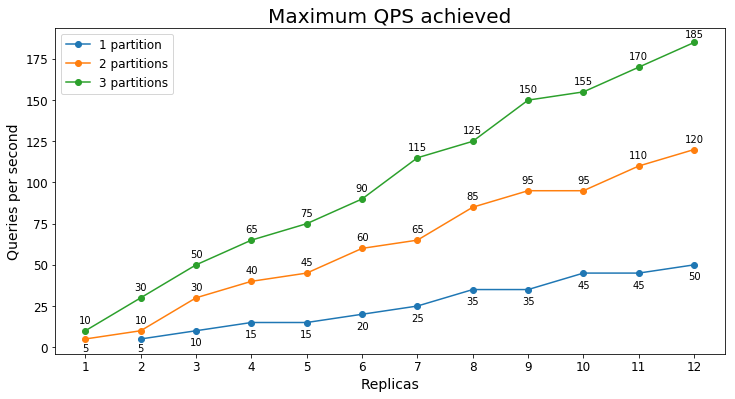

Queries per second
The following chart shows the highest query load a service could handle for an extended period of time in terms of queries per second (QPS).
In this case, we see that adding a second partition significantly increases the maximum QPS but adding a third partition provides diminishing marginal returns. The smaller improvement is likely because all of the data is already being pulled into the S3's active memory with just two partitions.

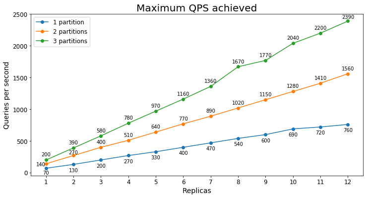

Queries per second

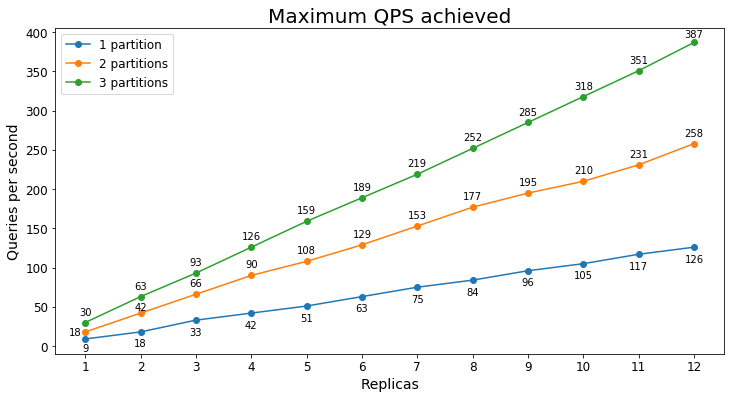

Queries per second
