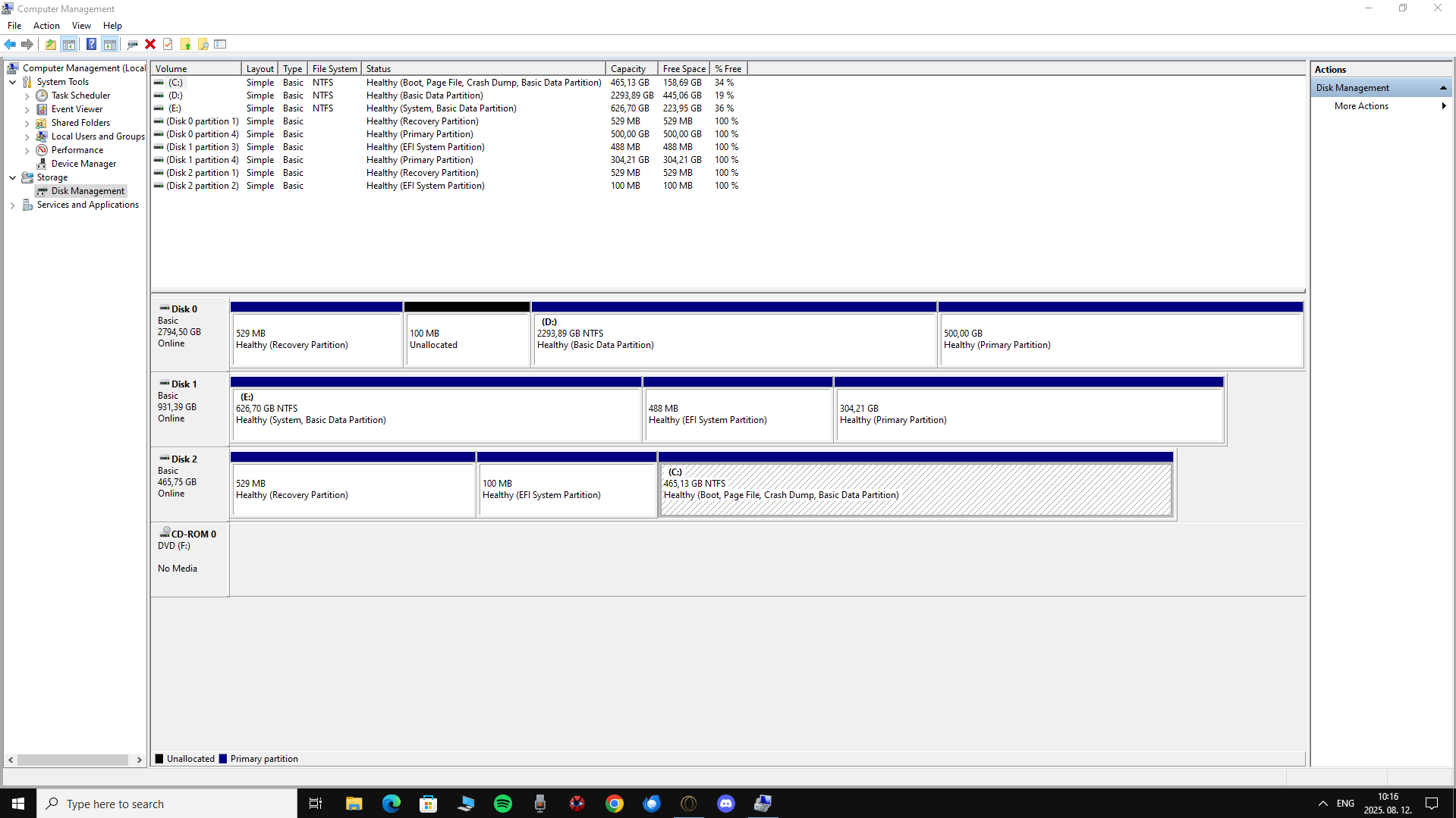

Can you temporarily disconnect Disk 1 and boot into Windows and install the update? The EFI partition on Disk 1 is likely causing the update to fail.

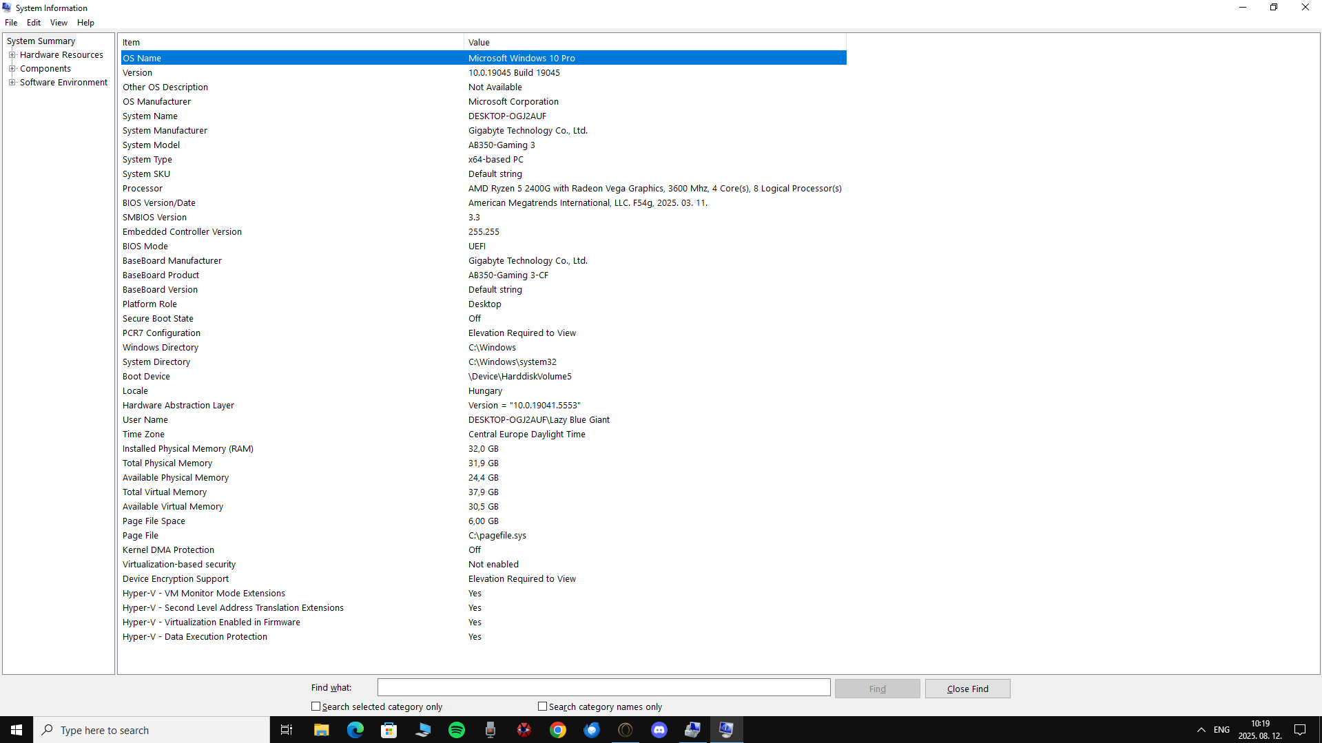

    I'm starting to think what the problem might be. But I'm not sure yet. Here are the screenshots you asked for.dskmnt
    msinfo

  2. Ramesh Srinivasan 90,315 Hírnévpontok Független tanácsadó
    2025-08-12T02:34:40.77+00:00
    Hi Pácsa-Varga,
    Thanks for the logs. There was a problem updating the boot files.
    1. Please open Disk Management and maximize it. Adjust the column widths in the top pane to make all the entries visible. Post a screenshot.
    2. Run msinfo32.exe, and click System Summary. Resize the columns in the right pane to make the entries visible, and post a screenshot.
