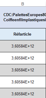

Essaie :
Sub Nettoyage2()
Dim C As Range, Sh As Worksheet, Lig As Long, Col As Long
Application.ScreenUpdating = False
For Each Sh In Sheets
With Sh
.[B:B].Replace "~*", ""
.[B:B].Replace " ", ""
.Range("B3", .Cells(.Rows.Count, 2).End(xlUp)).NumberFormat = "#"
For Each C In .Range("B3", .Cells(.Rows.Count, 2).End(xlUp))
If C <> "" Then
If IsNumeric(C) Then
C = C * 1
End If
End If
Next C
End With
Next Sh
Application.ScreenUpdating = True
End Sub
