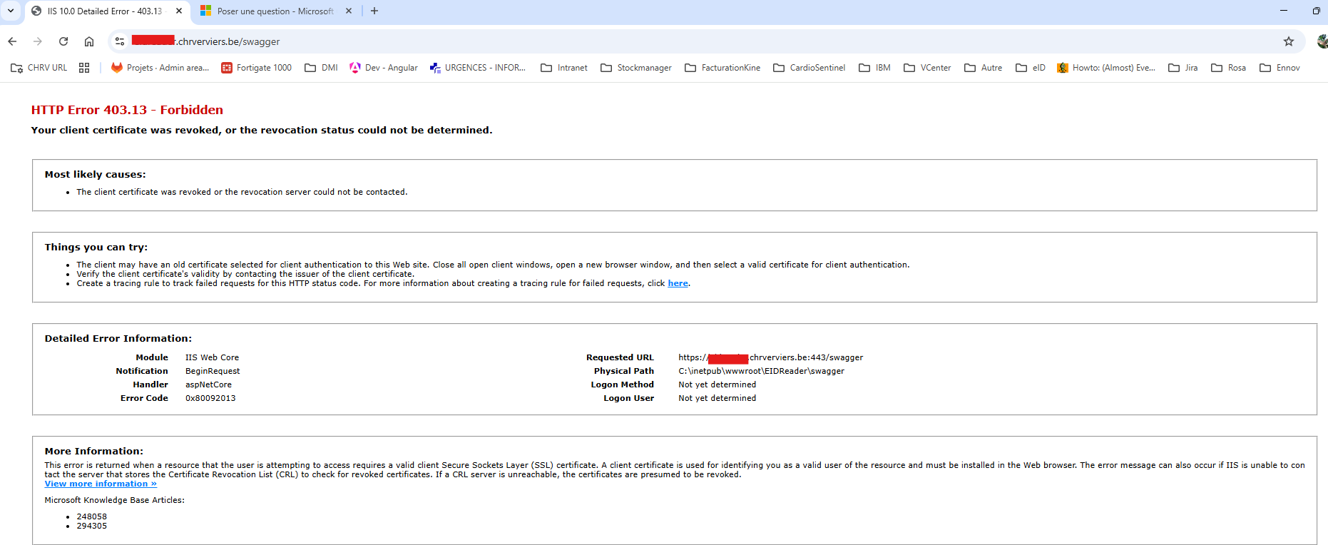

I believe I've done things correctly but I'm still stuck on a "HTTP Error 403.13 - Forbidden
Your client certificate was revoked, or the revocation status could not be determined." error.
This error only happens when app is deployed and ran on the IIS.

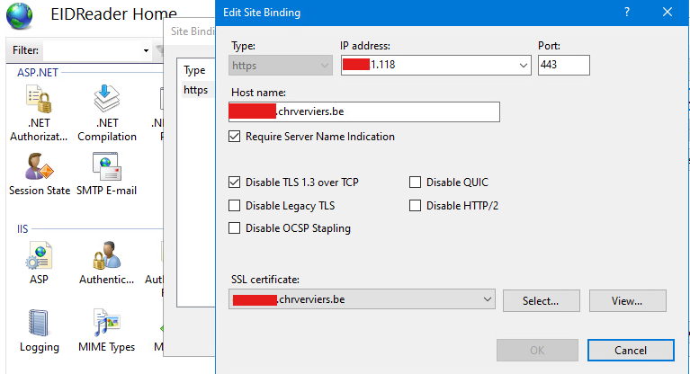

Here are a few screenshots to show the configuration of the IIS
Bindings:Image de l’utilisateur
(I disabled TLS 1.3 over TCP because it would cause a "CONNECTION_RESET" error in chrome)

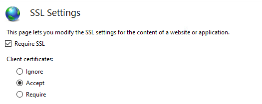

SSL Settings:
(I used "Accept" as this is only a test server)

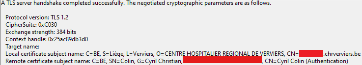

The Event Viewer Logs:

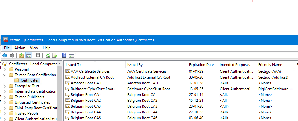

Image de l’utilisateur The Trusted Root Certification Authorities:rootca
I imported all Belgium Root CA's in the Trusted Root CAs of the server.

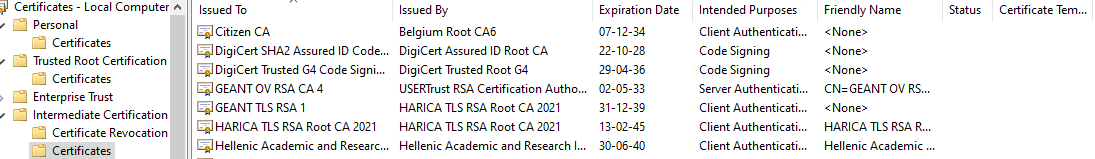

Il also imported the current Intermediate Citizen CA in the Intermediate CAs of the server:
The actual 403 error:

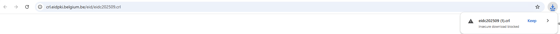

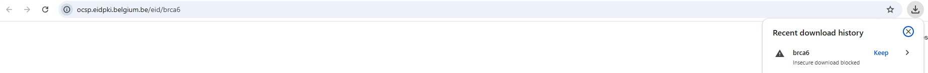

I do not know why I still have this error as the CRL and OCSP are accessible from the server (using edge also works):
And I found a command to run on the server that also seems to state that the certificate is valid and that revocation checks passed.
