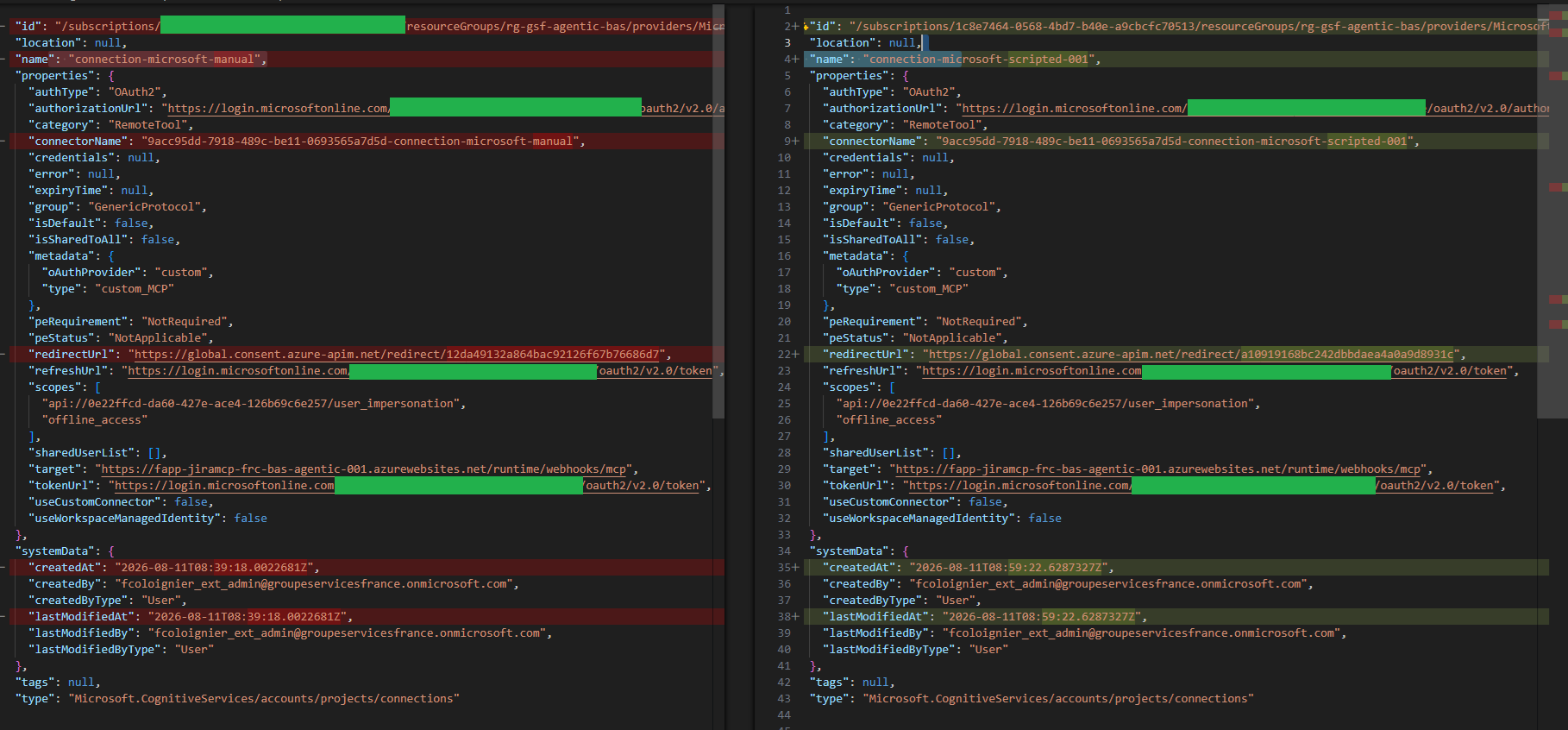

The creation of the connexion is succesfull and when i check the JSON of the created connection with the command line it's exactly the same as the one created with the portal.
Unfortunately, when change the "project_connection_id" from the connection created using the portal to the one created by script it doesn't work anymore (i've also tried to create a new agent, it doesn't work either)
