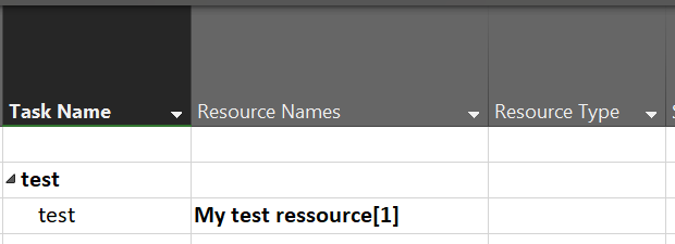

Here’s the issue I’m facing: I’ve set up resources in the Resource Sheet and assigned each one a type—Material, Cost, or Work. However, when I view the Task Sheet or any Gantt Chart view, the "Resource Type" column remains blank.
The resources are properly configured and assigned to tasks, so I’m not sure what’s going wrong.

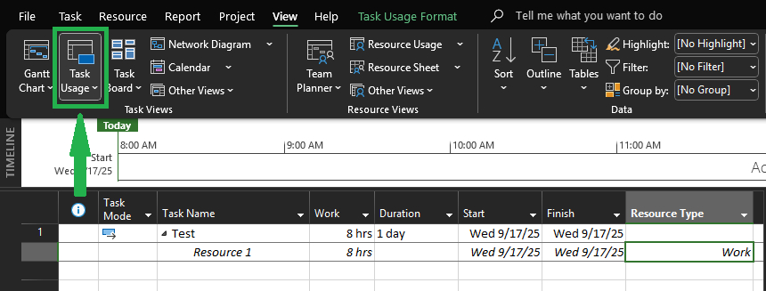

Thank you for your clear follow-up and confirmed that the resource type is visible in the Task Usage view!
However, about your concern, I’m sorry to share that, as far as I know, it’s currently not possible to display the resource type directly in the Gantt or Task Sheet views, even though the column is present. This is because those views are primarily designed to list tasks and illustrate their relationships and schedules using Gantt bars. For more detailed breakdowns, especially regarding resource assignments and cost types, the Task Usage view remains the most effective option.

    Once resources are assigned, it's important to note that the Resource Type column does not automatically populate in task-based views. The type (Work, Material, Cost) is a property of the resource itself, not of the task.
    To view the resource type details within a task view, click the small triangle icon (expand button) left next to the task name. This will reveal assignment details, including the resource type.
