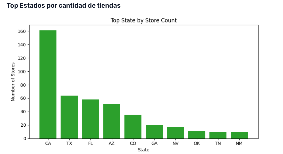

For example, in Azure Foundry using gpt-4.1 + Code Interpreter, the agent responds without problems and generates the requested chart:
Captura de pantalla 2026-02-17 143337
