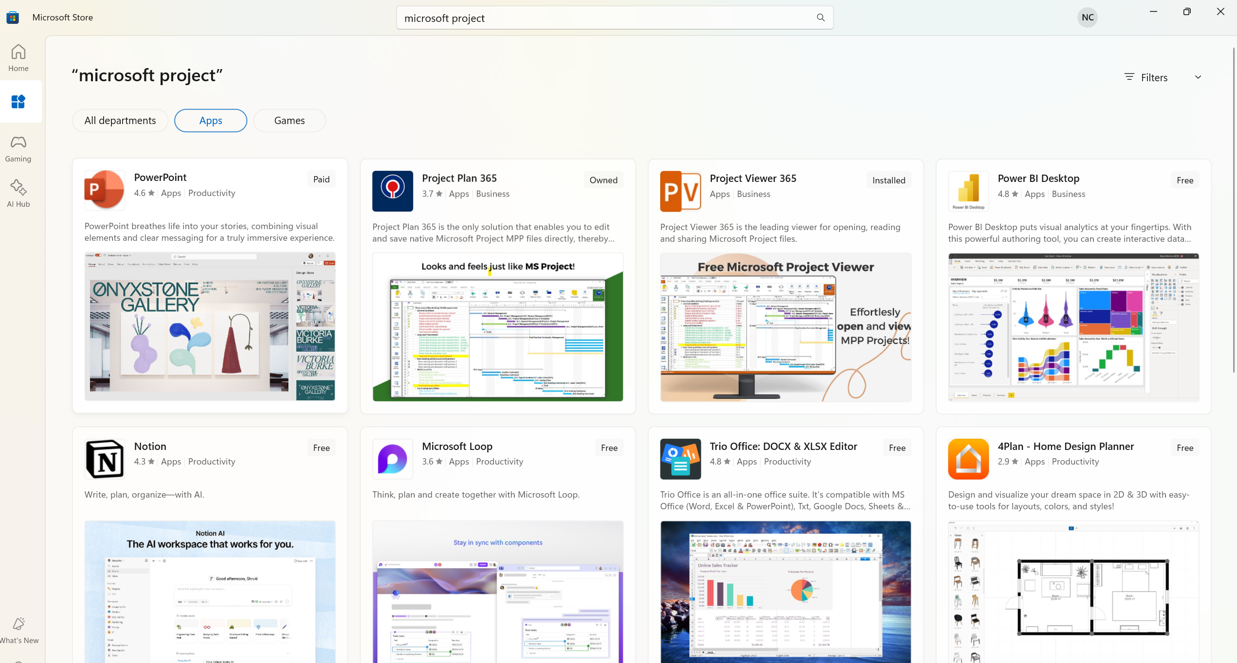

    I'm in the US so not sure if it's regional but I can't download MS Project (desktop App)
    Imagen del usuario
    Looking into it, at least on my case it says Project was discontinued.

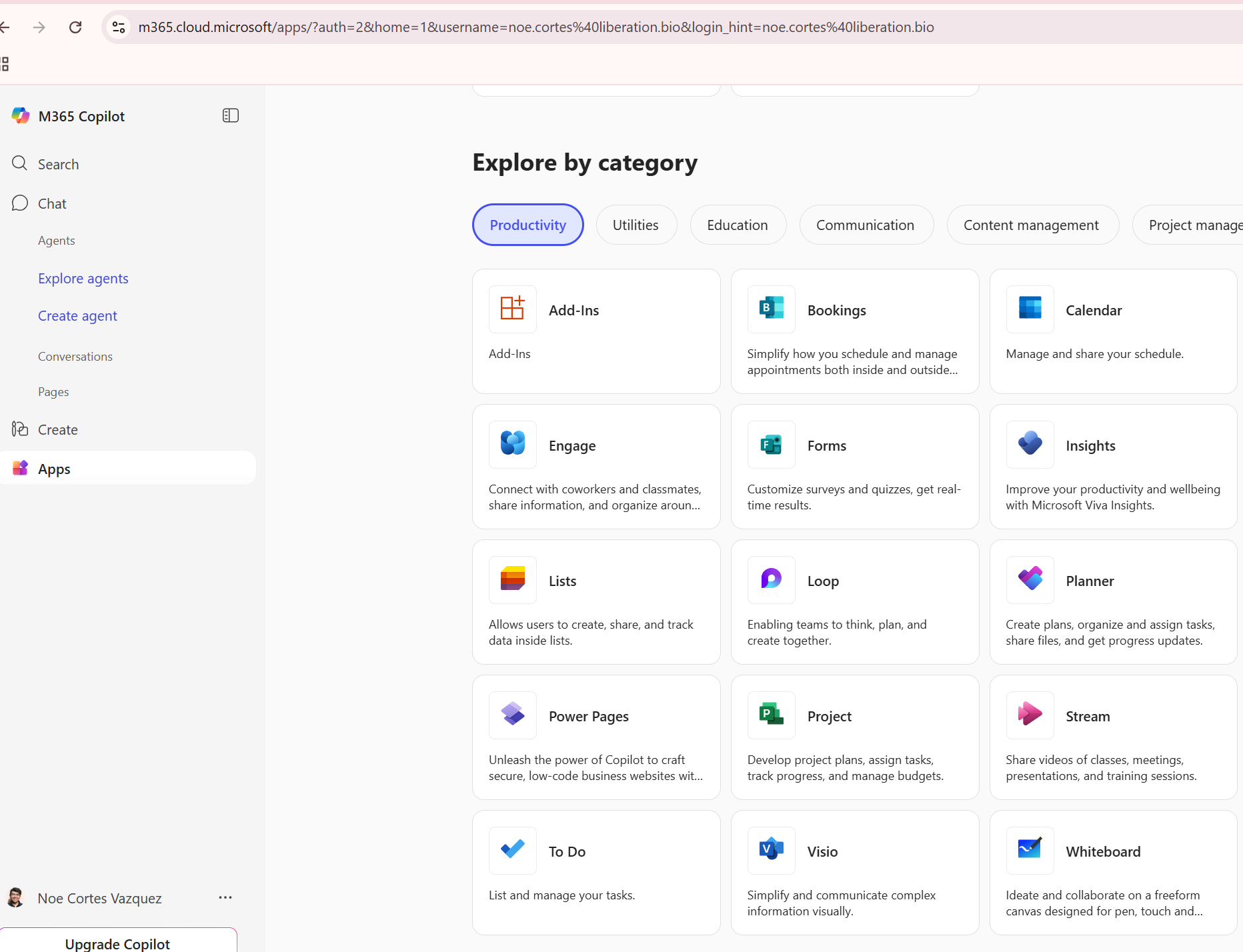

    • If there's an error message during the opening attempt, could you share a screenshot of the error message you're seeing? R: If I go to my M365 cloud, there's a MS Project App, however when I open it, it Opens the Planner App, which to me at least only works to create a file, because there is not an option to open the downloaded .mpp file.Imagen del usuario

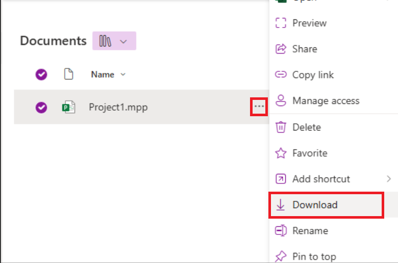

    1/ Download the Project file from SharePoint:
    Go to your SharePoint site and locate your Project file
    Click the three-dot menu next to the file > select Download Imagen del usuario
    Open the downloaded file and check if the issue persists.

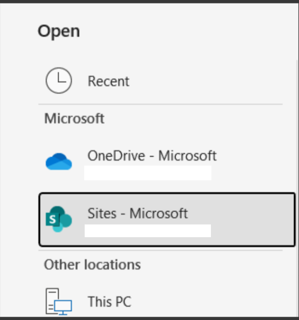

    2/ Open the file using Microsoft Project desktop:
    Launch Project on your device > Select Open
    Imagen del usuario

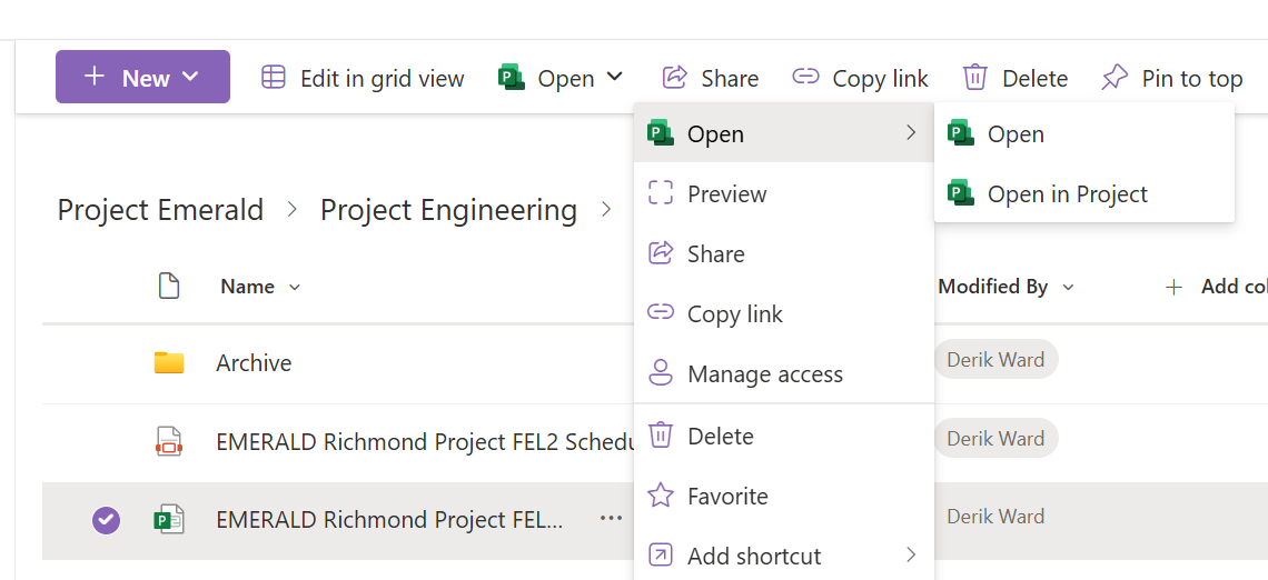

    Navigate to and click Sites > select the site where the file is stored > Click on the file and open it.
    Imagen del usuario
