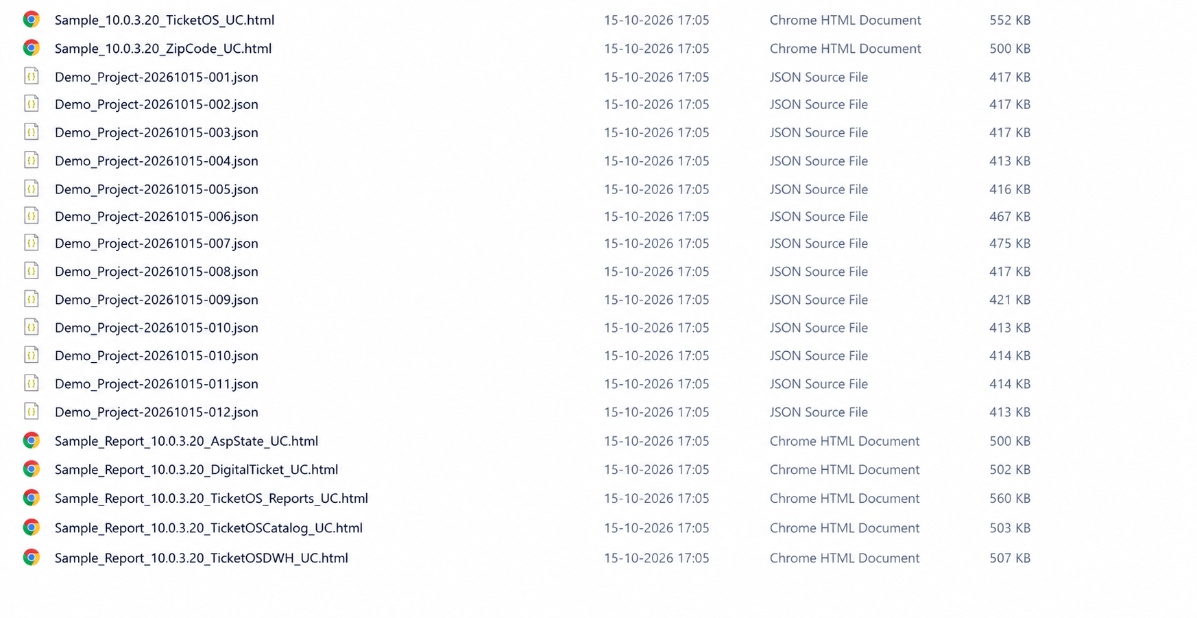

Hello Microsoft Team,
I am using the Get-AzDataMigrationAssessment PowerShell cmdlet from the Az.DataMigration module to generate SQL Server migration assessment reports.
The assessment covers the following three scenarios:
  1. AzureSQLDB
AzureSQLManagedInstanceDB
SQLRunningOnVmAssessment
Previously, the assessment results for all three scenarios were generated in a single JSON file with a consistent structure.
However, we are now observing inconsistent behaviour across different systems. In some environments, all three assessment results are included in a single JSON file, but the JSON structure or format differs between systems. Additionally, an HTML file is also being generated in some environments.
Environment details:
Operating System Build: 10.0.26100.9444
PowerShell Module: Az.DataMigration
Module Version: 1.1.1
Module Path: C:\Program Files\WindowsPowerShell\Modules\Az.DataMigration\1.1.1\Az.DataMigration.psd1
Could you please clarify the following?
Is Get-AzDataMigrationAssessment expected to generate a single JSON file containing assessment results for all three scenarios (AzureSQLDB, AzureSQLManagedInstanceDB, and SQLRunningOnVmAssessment)?
What is the official JSON output structure or schema? Could you please share a sample JSON file showing the expected format for all three assessment scenarios?
Is HTML report generation an expected and officially supported behaviour of this cmdlet? If yes, under what conditions is the HTML file generated, and what is its intended purpose?
Why might the JSON structure differ between systems even when the same Az.DataMigration module version is installed? Could this behaviour depend on the PowerShell version, configuration file, assessment settings, or other dependencies?
Is there any known issue or recommended configuration to ensure consistent JSON output and predictable HTML file generation across different systems?
Are there any documented changes in output format or report generation behaviour between different versions of the Az.DataMigration module?

Our objective is to understand the expected output format and file-generation behaviour so that we can process assessment results consistently across different environments.
Please confirm the expected JSON structure, whether HTML output is supported, and any relevant troubleshooting steps or official documentation.

  1. Deepesh Dhake 1,325 Reputation points
    2026-10-21T17:55:02.7966667+00:00
    From the module source, Get-AzDataMigrationAssessment is a thin wrapper around a separate console app, SqlAssessment.exe. The console app, not the cmdlet, decides file names, formats, and whether HTML is produced. When you use -ConfigFilePath, your config file is passed directly to it. The documented output is a single SqlAssessmentReport.json.
    Why the output may differ on the same module version: In Az.DataMigration 1.1.1, the cmdlet downloads the console app from https://aka.ms/sqlassessmentpackage only if it isn’t already cached under <DefaultOutputFolder>\Downloads. There’s no update check afterward, so each machine keeps whichever build it first downloaded. That would explain the different JSON structures.
    A few steps that may help:
    Compare the SqlAssessment.exe version on each machine:
       Get-ChildItem $env:LOCALAPPDATA -Recurse -Filter SqlAssessment.exe -ErrorAction SilentlyContinue |
         Select-Object FullName, @{n='Version';e={$_.VersionInfo.FileVersion}}
    Delete the cached Downloads folder on each machine and rerun, or deploy one pinned build everywhere.
    Use the same config file across systems, with a separate -OutputFolder for each run.
    One small observation: your listing shows Demo_Project-20261015-010.json twice, which isn't possible within a single folder. It may be worth checking the full paths, since the files could come from different runs.
    I'm not aware of a published JSON schema. If you need one, the Azure/azure-powershell GitHub repo would be a good place to request it.
    Reference: https://www.powershellgallery.com/packages/Az.DataMigration/1.1.1/Content/DataMigration.Autorest%5Ccustom%5CCmdlets%5CGet-AzDataMigrationAssessment.ps1

    The screenshot shows multiple numbered JSON files and per-database HTML files rather than the single SqlAssessmentReport.json shown in the official example. Before attributing every file to this cmdlet, reproduce into a new empty output directory and capture the loaded runtime—not merely the module present under C:\Program Files\WindowsPowerShell\Modules.
