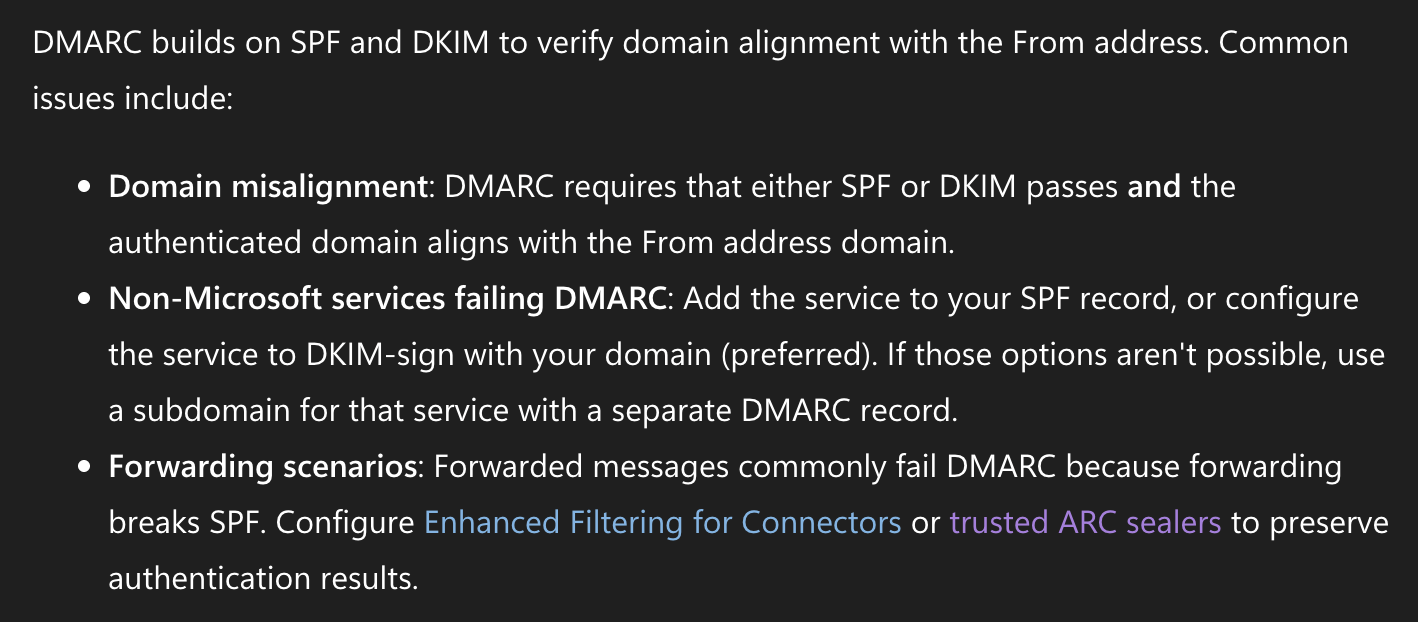

    I don't have administrative access to the sender's Exchange Online tenant. I operate the email gateway on the forwarding path and am investigating a DMARC alignment issue observed downstream.
    From the message headers we captured when the email first reaches our gateway, we see:
    From: [email protected]
    DKIM-Signature:
    d=example.onmicrosoft.com
    This DKIM signature authenticates successfully, but it does not align with the visible From domain example.com.
    After the message is forwarded through our gateway, we use SRS, so SPF also passes authentication but the envelope sender uses our gateway domain. Therefore, SPF is no longer aligned with the original From domain either.
    As a result, downstream receiving servers that enforce DMARC strictly can evaluate the forwarded message as DMARC fail and may quarantine it as spam or reject it.
    We understand that signing with the onmicrosoft.com domain may be expected if DKIM for the custom domain is not enabled. However, we would like to understand whether there is a recommended configuration on the Microsoft 365 sender side that would allow the outbound message to carry a DKIM signature aligned with the custom From domain.
    Could you please confirm:
    1. Is DKIM for the custom domain required/enabled on the sender's Microsoft 365 tenant to achieve DKIM alignment?
    2. If it is enabled, why would the outbound message still contain d=example.onmicrosoft.com?
    3. Is there any Microsoft-recommended approach for forwarded messages where SPF alignment is lost due to SRS, so that DMARC can still pass through downstream receiving servers?

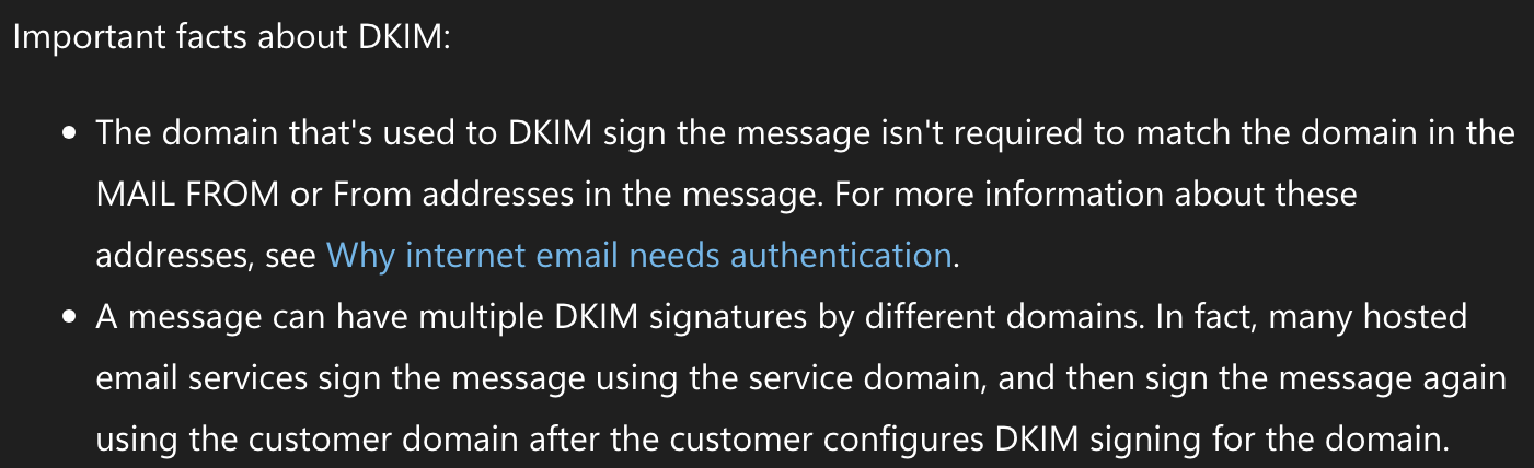

    Yes, this is expected if DKIM signing for the custom domain is not enabled and Microsoft 365 is signing with the tenant’s *.onmicrosoft.com domain instead.
    Key points:
    1. *.onmicrosoft.com is signed by default
      • Microsoft 365 signs outbound mail for the initial *.onmicrosoft.com domain by default.
      • No public DNS DKIM CNAME records are required for that Microsoft-managed domain.
    2. Custom domains require separate DKIM configuration
      • For a custom domain such as example.com, DKIM signing needs to be enabled for that domain.
      • This requires publishing the two DKIM CNAME records for the custom domain and then enabling DKIM signing.
      • To verify the current state, run:
             Get-DkimSigningConfig | Format-List Name,Enabled,Status,Selector1CNAME,Selector2CNAME
      • If the custom domain shows Enabled: False and Status: NoDKIMKeys or CnameMissing, create the required CNAME records and then enable DKIM:
             Set-DkimSigningConfig -Identity example.com -Enabled $true
    3. DMARC alignment requires DKIM for the From domain
      • Microsoft’s guidance for combined authentication failures is to enable DKIM signing for the From address domain because DKIM alignment provides the aligned pass that DMARC needs.
      • If mail is signed only with example.onmicrosoft.com, that DKIM domain does not align with From: [email protected].
    4. Why ARC can show dkim=pass header.d=example.com
      • ARC preserves authentication results.
      • The provided context supports ARC as a mechanism that preserves authentication results through message modification, but it does not document a case where ARC reports header.d=example.com while the visible outbound DKIM-Signature is d=example.onmicrosoft.com.
      • The supported conclusion is that the actual DKIM signature used for downstream DMARC evaluation is the one in the message headers. If that signature is d=example.onmicrosoft.com, then custom-domain DKIM for example.com should be checked and enabled if the goal is aligned DKIM for example.com.
