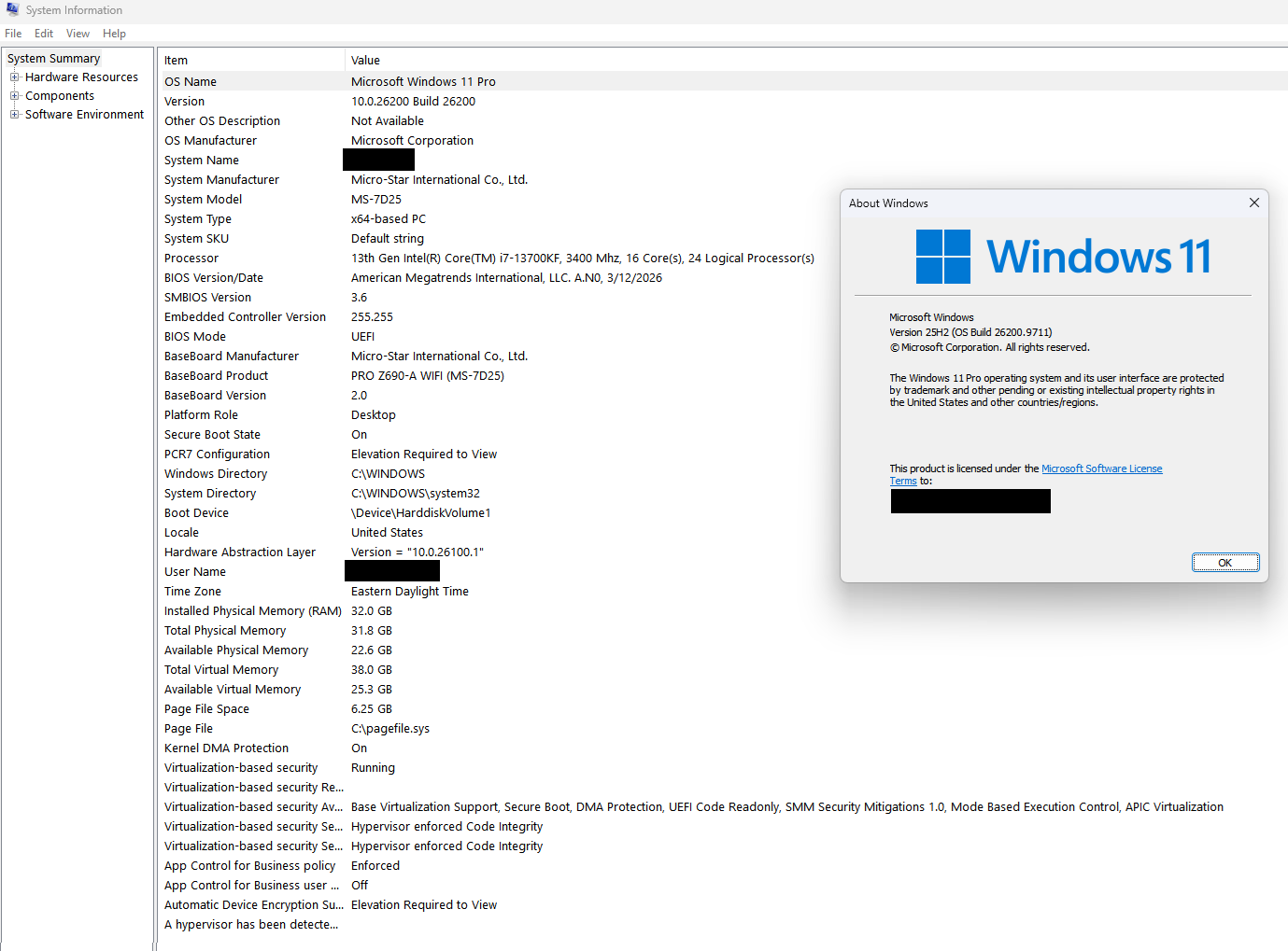

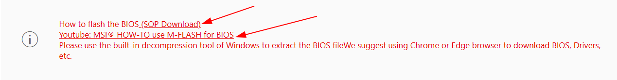

Given that the issue appeared immediately after updating the BIOS on your MSI PRO Z690-A WIFI, you should check the MSI support page for this exact motherboard next. Compare the installed A.N0 BIOS with the currently available BIOS releases and review the release notes for any USB/audio-related changes. Also install the current motherboard chipset drivers directly from MSI if they are newer than those presently installed.
If the behavior remains specific to the Logitech headset after that, I’d recommend contacting MSI Support with the BIOS version and the before/after behavior. That would help determine whether there is a BIOS/USB compatibility issue before making major changes to Windows.

Manoel Barros 22,495 Reputation points Independent Advisor2026-10-15T22:41:31.3566667+00:00 Hi!
Please provide the full model name of your motherboard as well as your headset. This information is important.
- Press WINDOWS + R > Type "msinfo32" > Send me a screenshot of the "System Summary" page.
- The "System Summary" page includes the version of the BIOS currently installed, which will also be important.
- Press WINDOWS + R > Type "winver" (no quotes) > Take a Screenshot of the Window and send it to me
